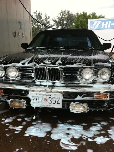

    Today was an interesting day... It started off good. Took the bimmer to the car wash.
