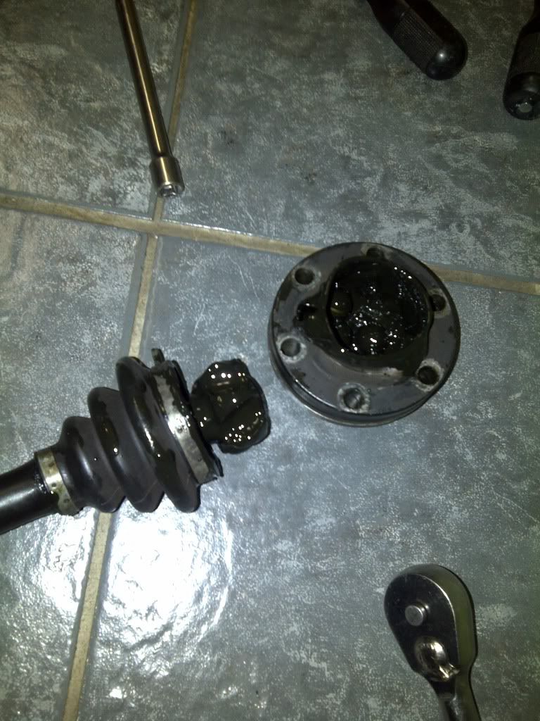

not sure what u guys call it, driveshaft/sideshaft/cv but anyway does anyone know or have the formula to strengthening these ? ....
note that im using street tires...

what kind of situation / power did you do this with?

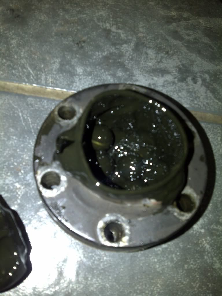

these units are pretty strong, the e92 335 uses a 86mm cv just like the e30 does, looks like you had a unusual failure at the outer race/ball area, CV axels usually kill boots before destroying anything else-
normal road situation, street tires(new), floored first gear, selected 2nd and left clutch and bang...... 328nv turbo motor ,,,335hp

what kind of diff are you shocking the axels with?
perhaps time for you to get a Z3m rear X member and run the bigger e36M size halfshafts? or call Driveshaft shop? my friend broke the e36m axels on his boosted 24v so he got DSS axels and stubs and seems to hold up (drag racing)
or perhaps convert to the e34 style bolt on half shafts? those seem to not break under boost-

the Z3m rear x member with its arms is an upgrade for e30's, its cv's are the stronger E36M evo2 style (hollow cv shaft style) ~96mm vs 86. USA e36M got these axels in the 3200cc s52 models later in production run.
dss axels and bmw medium case 188mm setup in a local E36 drag car w 4 bolt driveshaft has been proven to mid 9's in 1/4 mile, its pretty stout stuff lol zf 5mt, does not do it though.
is it possible to find the stub axels from a e34 or similar and convert to its Bolt at hub style use its setup instead of the e30 style axel that has a male output end at axel?
the e34/32 halfshafts should be strong enough if you get the bigger v8 or manual i-6 or big m30/s38 size units, the e32 v12 uses same size halfshaft and CV as M30 e34 manual. Friend has a boosted 3200cc e34 mid 500's rwhp on standard rear end gear size/standard axels.
