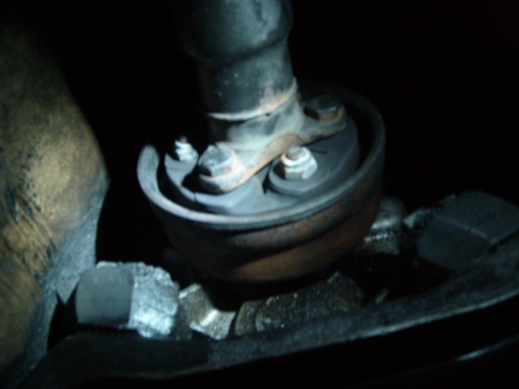

    i just installed my ssk last week and i couldnt change that piece..its sitting on the floor of my room.
    First you have to pop off a cover that keeps a pin in the selector rod. Hopefully your guibo thing isnt in the way like mine was. For some reason mine has this BIG ASS cover over it.lol So i had to leave it in.
Name:	guibo shield.jpg
    This damn cover sits right up underneath the hole for the pin so I couldnt slide it up or down. Soooo annoying!
    Im thinking once i replace that it will get rid of the slop.
    BTW... anyone know how to get this apart. messing with it last week made a bolt pop out. now i cant drive my car. oops

      I just want to add this to the mix, when I swapped the lever for a dssr,
      I had to change the rod joint as well since I needed a narrow one instead
      of the early ones wider.
      And I noticed this:
      The hole was oval but not from wear... this might also be a part of your
      problem.
