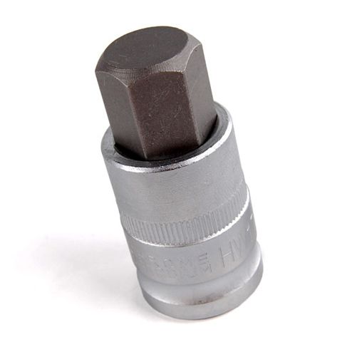

        usually you need the tool from pelican parts and a compressed (small) 1/2 socket to squeeze in there. the sockets from the auto parts stores are going to be way too long. you could shave it down if you wanted though and save some money i suppose. http://www.pelicanparts.com/cgi-bin/...ONLY%2C%20Each

          I use a hex socket in 17mm, but I've seen a big ass hex key used before. All have been done with the transmission off the car though. Guess I'm no help. Might be easiest just to order one online.

            Something like this would be too big?
            REMEMBER: Be safe and have fun is Rule Number 1.

                        I used a 17mm allen socket and a 17mm open wrench. Put the allen key in and use the crescent part of the wrench to turn it, it has enough clearance from the transmission to the base of the allen socket for the wrench to slide in.

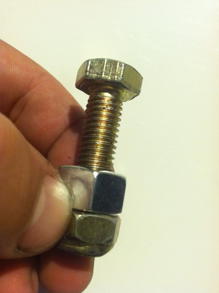

                          You can make one for free with a 17mm bolt and 2 nuts... (this one isn't 17mm but you get the point) If you want to loosen use the inside nut, if you want to tighten use the outside nut, Have fun!
                          benvideoproductions.com
                          http://www.youtube.com/watch?v=617yNrOrRfo&
                          • JrCamacho
                            • Feb 2011
                            • 618
                            thank you yeaseth! I thinking about doing that, and now i know it works!
