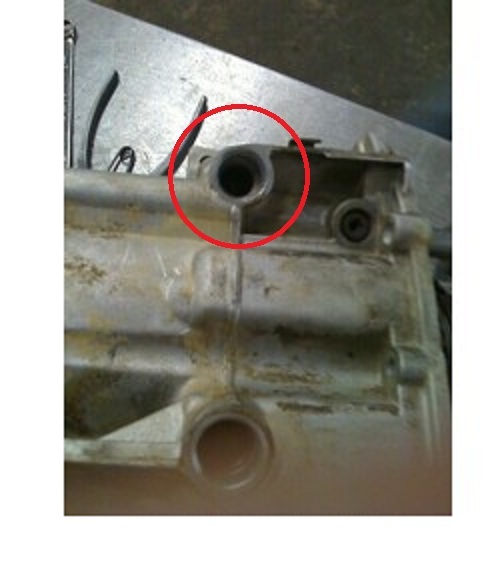

          Here's the picture they sent. They stated it is on the passenger side of the transmission in the upper portion of the rear (near the output). The transmission mechanic's exact words were "the linkage slides through this bushing to go into reverse". When I sent them the RealOEM transmission diagrams they were certain that the bushing was not on any of them.
          No pictures of the actual bushing, but the dimensions are as follows:
          Length: .800"
          OD: .780"
          The following picture is where the pushing is inserted.
