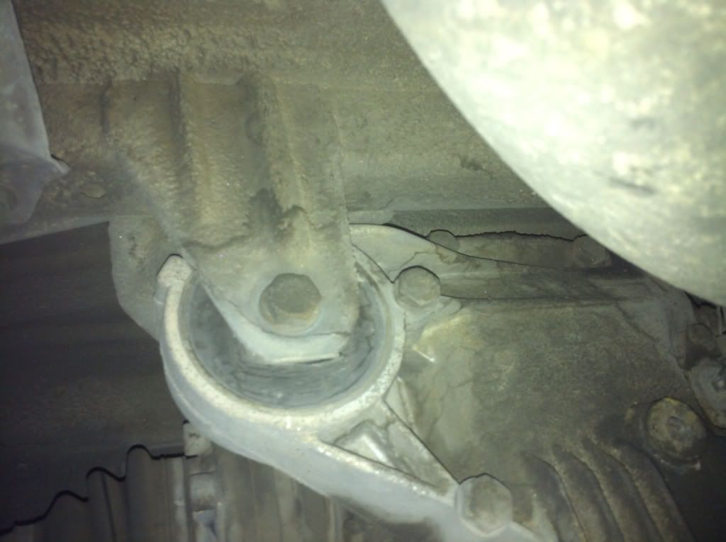

                  Ok thanks for helping guys,
                  Maybe I was wrong about that diff bushing it seems really soft and has a bunch off little rips on the surface , the CVs seem to be in good condition a little dirty but I was trying to move them with my hand and they didn't have any play.
                  88 325is Five Speed
                  Lachssilber
                  • e30leigh
                    • Mar 2012
                    • 481
                    that diff mount is stuffed. id check your subframe too. bet they are bad too. or not far behind.

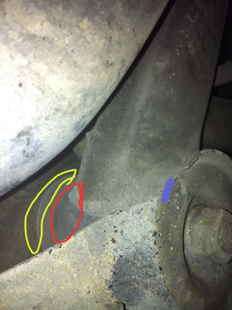

                    • Herr Faust Schinken
                      • Feb 2012
                      • 3580
                      I couldn't get that great of a photo but I still got one
                      So there's about and inch of space from the red which is the top of the subframe too the yellow which is where the subframe meets the chassis.
