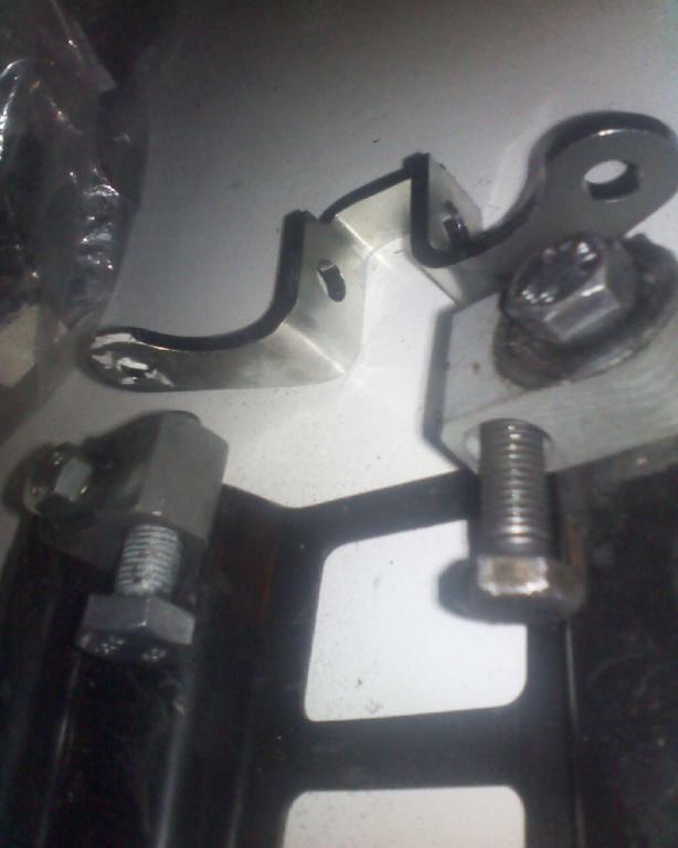

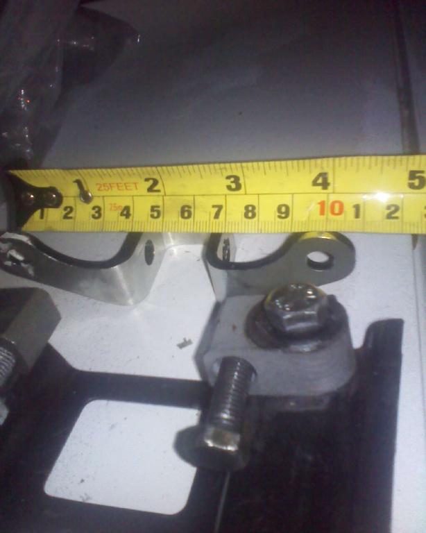

    ok so I saw that the ears for the later model alum. shifter were available so i went to the local u-pick and got one then sent for the delrin bushings and the new shifter bushing and clip. after I installed noticed that my assembly was about 3/4 of an inch forward of the body opening? I had to drive like this for awhile and then i saw that there was a metal Bow mount available that might resolve? I got one for an M3 but when it arrived I found that although in theory it should align things it was too wide by a bit.Click image for larger version

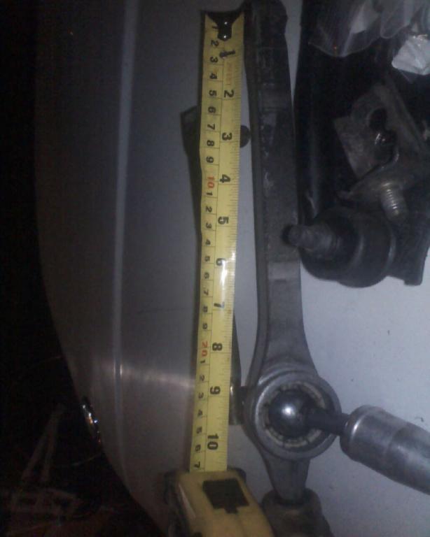

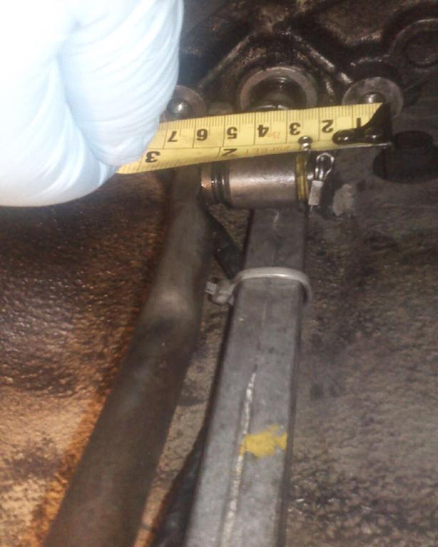

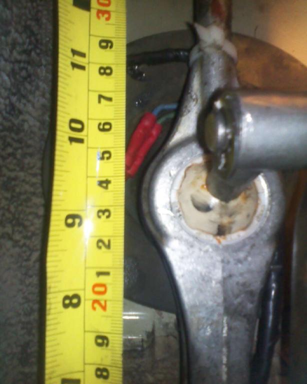

      so now i need to know if there is a bow that will fit this setup? or is there an arm that is at least 10 inches from front eye to shifter ball. the 2 I have are 9 1/4 inches?

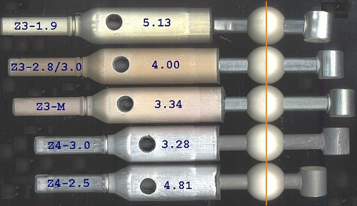

        I have been biddy bopping around the web and havent found any specifics for carriers like the one for shift levers.
        does anyone know if it exists?
