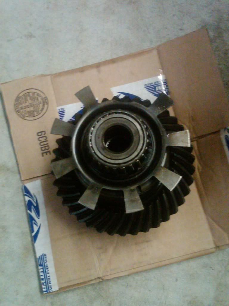

    Does anyone have a part number for this diff bearing?
    (the tapered bearing on top)
    https://farm8.staticflickr.com/7475/...1e97724413.jpg

    Go to realoem.com to get the part number. Understand that if the bearings in the differential are replaced, back lash, and pinion engagement depth will need to be checked and probably adjusted with the shims.

      You need two of PN 33131213893.
      When you replace the bearings it is critical to load only the inner part of the bearing, otherwise you could sacrifice bearing life.
      You seem to be missing a tooth on your chopper wheel. It should have 9 evenly spaced teeth.

        Thanks! I couldn't find a good picture of it on realoem.com......I did replace the chopper wheel with a good one...I messed up the bearing in the process.
