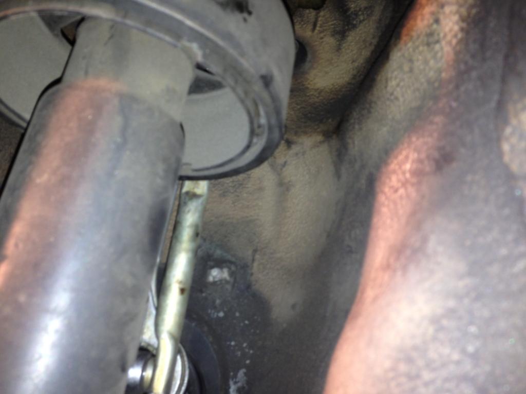

              So I got underneath my car and looked at my selector rod. It looks to be bent near the guibo. But I think the PO did this when he installed the short shifter so it wouldn't hit the guibo. When i grabbed the selector rod I wiggle it a little from the wholes it is sitting in. I provided in a picture. Please let me know I need to get my car up and running soon. Thanks a lot guys!

                That's how the selector rod is supposed to be. You didn't find anything disconnected?
                  nope. The selector rod just had a little bit of a wiggle in the places it stood. Can it be my slave cylinder?
