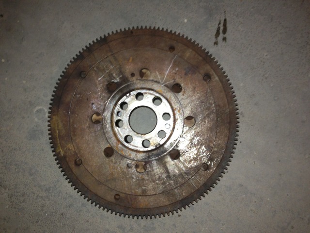

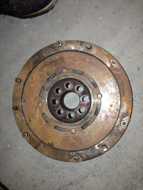

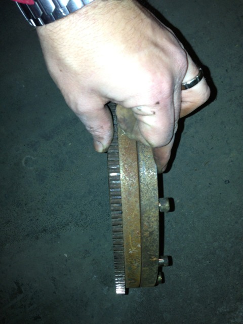

    This does not look like the flywheels I've seen for my car... Is this a dual mass instead of single?

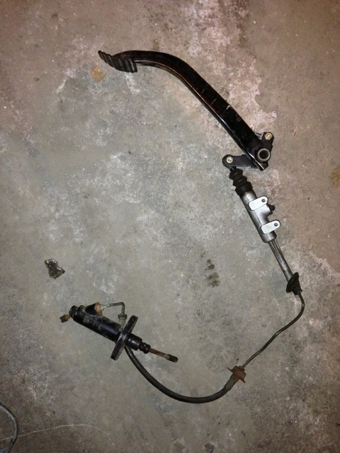

    The pedal seems to be missing a lot and is that slave cylinder right?

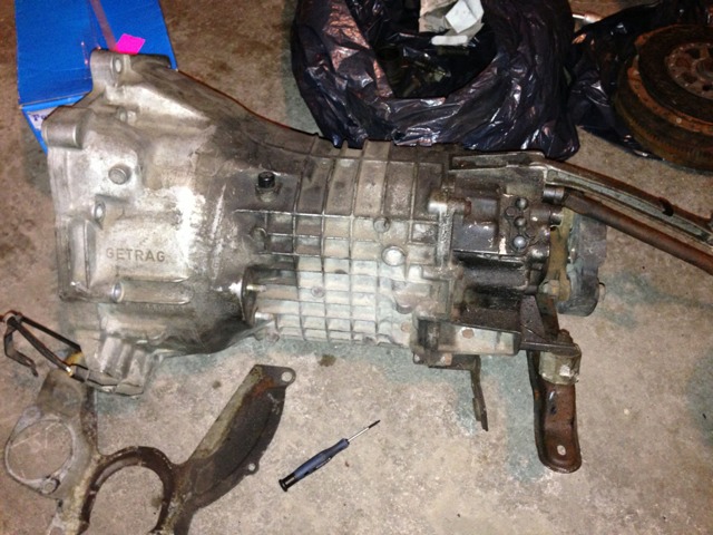

    Is this even the correct transmission? How could I check?

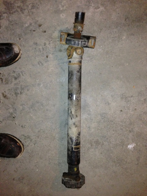

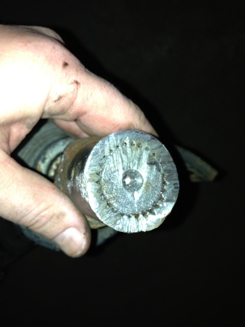

    Here's the "drive shaft". He cut it off, so I don't know if this can be connected to the remainder of my current shaft or if its toast.

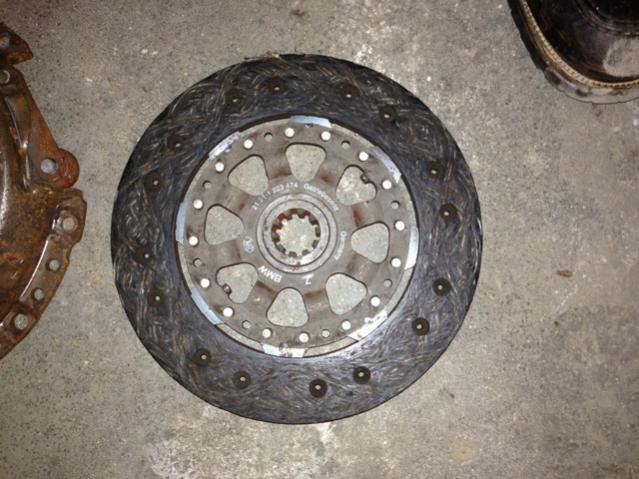

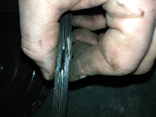

    How's the clutch look?

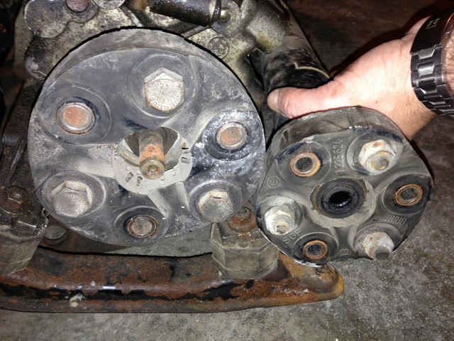

    The flex disc in the drive shaft is WAY smaller than the one on the tranny... What's up with that?

      that tranny is from a 325e

        I'd have to go home and look on the flywheel, something does seem weird about it, just can't place my finger on it. You have part of the pedal assembly, you have the pedal, MC, and slave cylinder right there. You'll need the mounting bracket crap for in the car. That's the correct tranny, I just pulled one out of my car.

            Did some digging. I have a late eta tranny. That flywheel is dual mass, because lat model etas used dual mass. Apparently I can make this work, but I need a few extra things.

              The transmission should work, but you need the single mass M20B25 flywheel and the matching clutch. The drive shaft is a throw away. You need one from any 325 car with a manual transmission. You may also will need need to change the transmission out flange to to one that accepts the small quibo, depending on what drive shaft you find.
