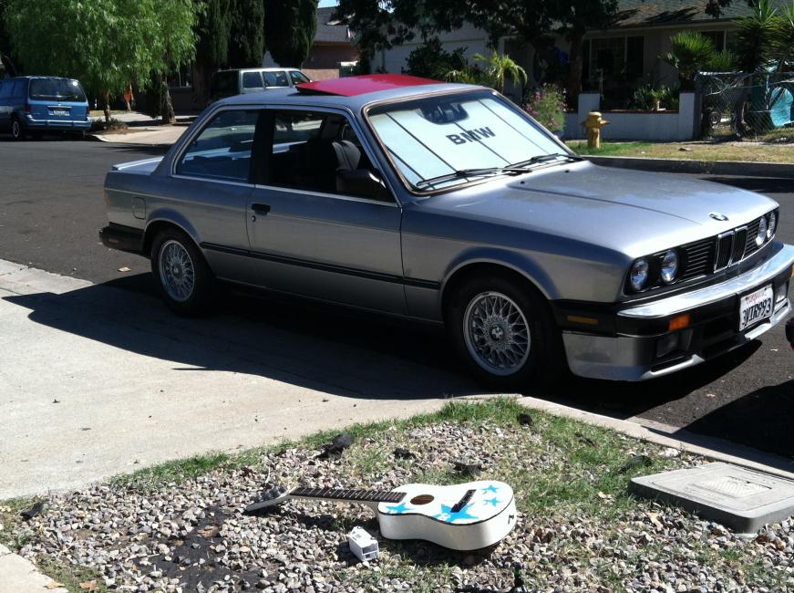

    Hey guys I bought an 87 325is 5spd a couple days ago and while I'm taking off in first it feels as if the car is lagging. Not enough umf. Idk if I just can't find the bite point or what (haven't driven stick in a while). There is no grinding or pop outs. Shifts perfect but I feel like a slug taking off :(
    So what could be the problem/solution?
    Would a different diff work? Upgraded maf? Chip? Maybe a new clutch?
    Or do I just need to learn how to drive lol
