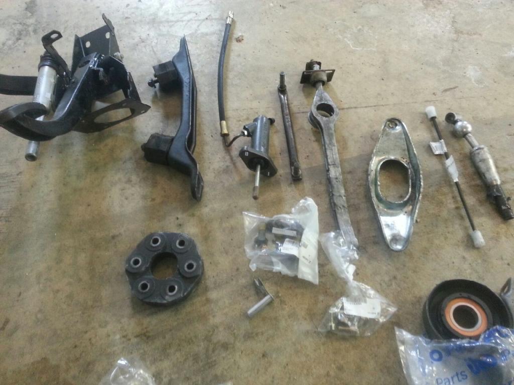

    What is this picture missing?
    Piecing together a 5 speed swap and Ill only have limited time in a friends shop to get it done next week, so I want to make sure I have everthing. SO whats missing in this pic?
    Things not pictured that i have:
    Clutch kit
    flywheel
    trans
    Thanks!

    drive shaft, brake fluid, loctite and shift knob

      Have those too!

        You can swap the pedal box ahead of time and still drive the car.
        Save the shop time for under car work.

          bolts.

            Bushing that the shifter ball sits in?

              reverse wiring

                I don't see: plastic hose connector for fluid line from reservoir, hose for fluid from reservoir, reservoir with hose fitting for clutch, plastic washers and securing clips for shift rod where it attaches to lever and gearbox, plastic pivot for clutch release arm in bellhousing, proper length flywheel bolts.

                  thanks fellas! I think I have just about everything now.. Except this clutch reservoir with hose fitting you speak of Chuck? And there is flywheel bolts there but they are in a bag, did you not see them or are you trying to say they are the wrong size?

                    One more part
                    I forgot the pilot bearing in the end of the crankshaft.
