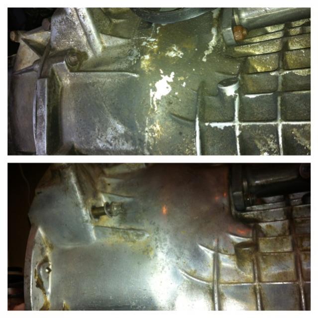

The picture shows a 88 325i Getrag 260.0.1346.90 on top and my 02/86 325e 260.0.127.90 on the bottom. Notice the differences. With the "e" the bolt goes through the sensor mount. with the "i" they've changed the senor mount and the bolt goes under it. There are other cosmetic differences. Also, if you measure from the bell housing edge to the slave plate it is 180mm on the "e". On the "i" it's only 176mm. So this is a later model "e" 260 that has a deep bellhousing with late model shifter mounts.
