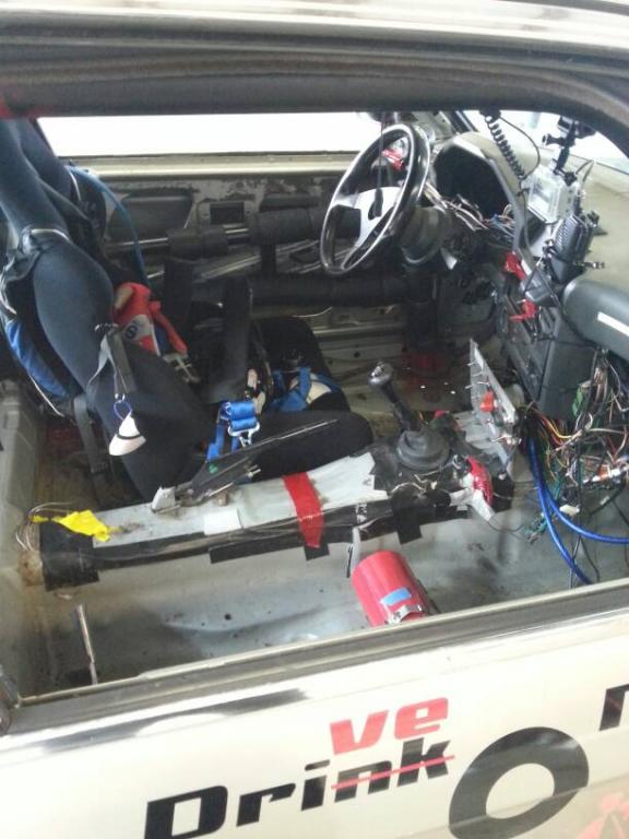

      Had a high boy shifter in my last drift car (240) and loved it and have been debating building one for this e30 but then happened upon this.
      I noticed the possible angle increase of the selector rod also but if need be i can modify or fabricate a new selector rod (I have plenty of fab experience)
