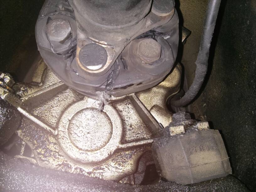

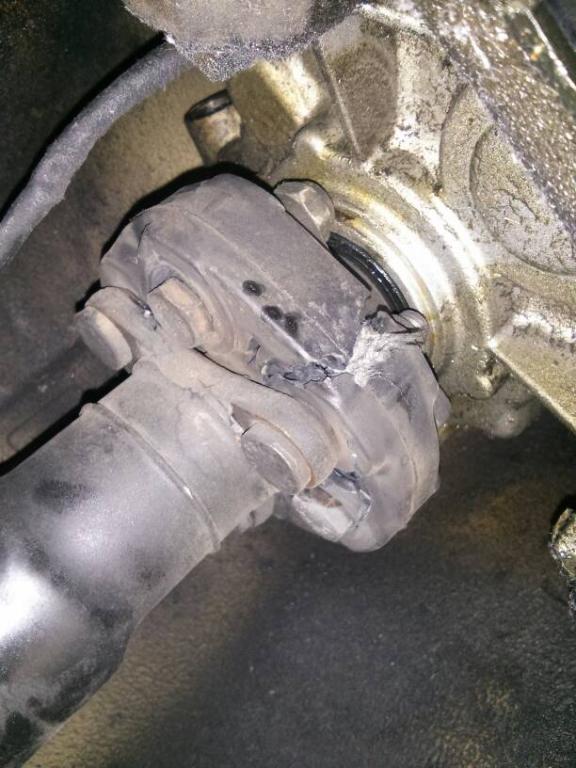

          • amarino
            • Oct 2013
            • 90
            Are you sure the driveshaft was properly balanced/aligned before it was installed. I am having the exact same issues that you describe in 1st, 2nd, and 3rd but I already know my problems are the guibo. I plan on replacing it this weekend.
