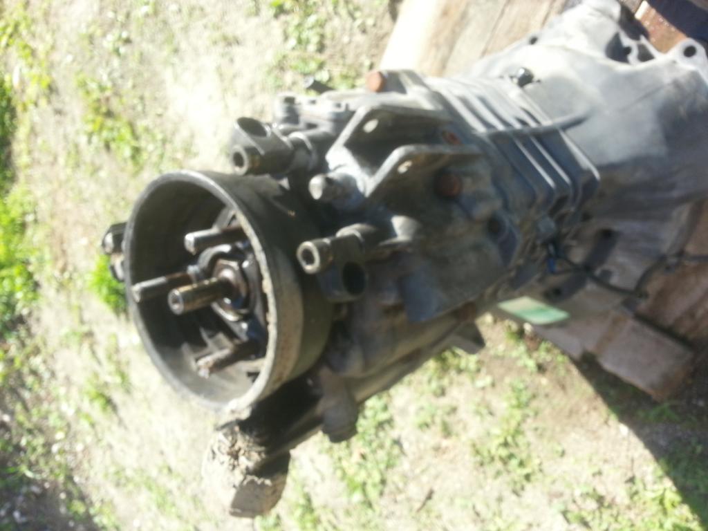

    Early style sheet metal shifter
    For starters I hate the slop in the shifter, is there a way to fix most/all of it with the early style? Or do I need to try and convert it to late style? I did do a Google search for like 20min and found nothing. So any help or suggestions are welcomed, thanks.

    If your trans has the raised slots for the later style shifter you can add it to your trans like from my 86 eta. If it doesn't have the 2 slots on the top of the trans I don't think you add it. My trans came with the sheet metal shifter. Hope this helps.

        Everything to build the early style shifter is still available new. Part numbers are on RealOEM.
        The only way to convert your car to the late style shifter is if it's a 86 and newer. The 84-85 transmissions don't have the provision for the late style carrier.

          Yeah that's what I was just noticing. I'm building my eta which is an 84, doesn't have those ears. On another note am I only able to do oe style replacement parts, no upgraded bushings or selector rod? Also am able to remove that ugly looking balancer on the tail shaft as well?
            Yes you can. Mine is removed. You have to use a thin wall 30mm and large deep socket.easy if you have a impact gun.
