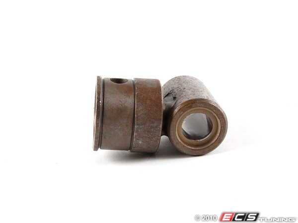

    New shift joint for G260 has oval hole, not round, has play in linkage? WTF?
    My old linkage has oval hole and because of that, has play in the shifter linkage, then I buy new one from ECS and the hole is exacly the same, oval and that causes the shifter to have some extra rearward-forward play.
    http://www.ecstuning.com/BMW-E30-325...ain/ES2091474/

    That picture certainly isn't one of a new OE/OEM part...

      Yes, the are made that way. My OEM unit looked exactly the same.
      I think only the early wide ones are like that.

        Yep. The one on ECS looks like it's been used or sitting for years
        IMG_3658 by mattrides, on Flickr
        Late model, and perfectly round.
