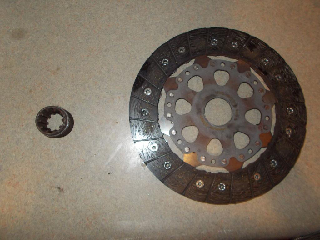

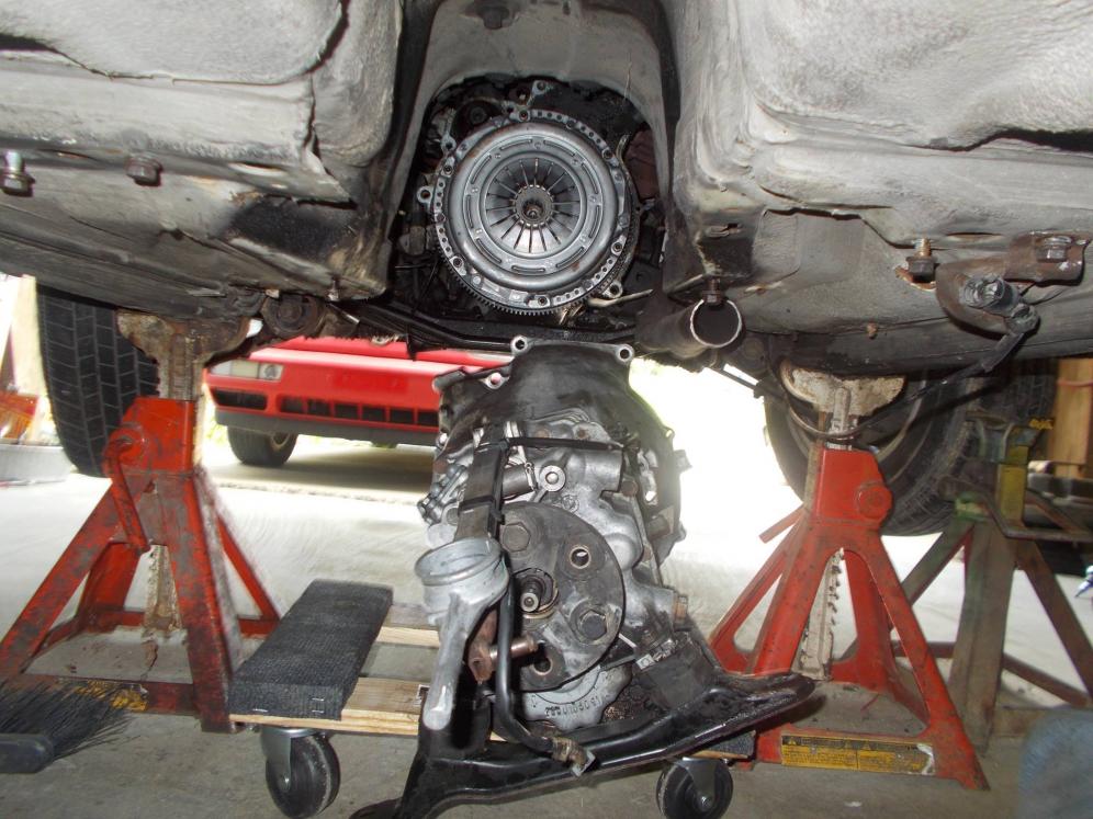

            I'll update in a few weeks aft transmission is out w/pics.
            • Ark
              • Jul 2013
              • 16
              Yep, Clutch disk came apart. Had to make a call to Sachs today.
