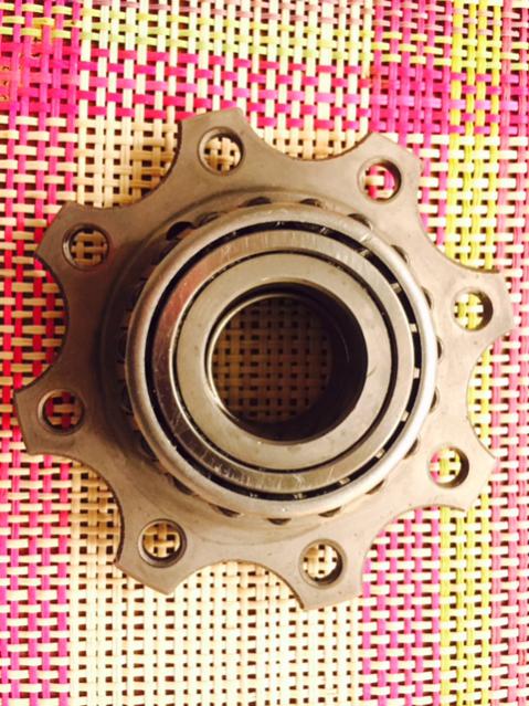

    Also looking for housing cover for ring gear side. Part # 33141210616.

    This part with or without the bearing is what I'm looking for.
    Thanks for the photo Jaker.

      There are two varieties of top caps for the small case diffs. The one you have pictured is the later variety (so one from an E21 LSD would not work).
      I think I have a side shot of the two here ....
      http://www.bmw2002faq.com/articles.h...ial-build-r74/
      In regards to your issue, your best bet would be buying a billet one from Rob Inhout. They are extremely under-priced considering his expertise (click here for his backstory). Recently an eastern-european place copied it but they were terrible (tolerances weren't even close). New ones are NLA from the dealer.
      Here's Rob's piece.
      http://www.ebay.com/itm/BMW-168-mm-s...FV9aJA&vxp=mtr
