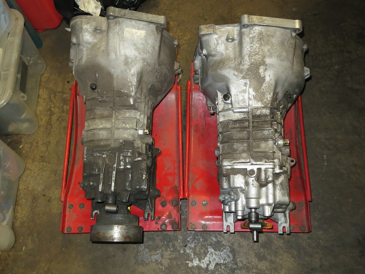

                  One other question. How do you know what rod joint to get? This is a mid year trans with mounting holes for both types of shifter arms and currently has the ofset joint.

                    I'm tagging alone in this thread as I have a similar problem.
                    I have an older E30 (323i -85) which is designed to use the old style of linkage (stamped steel)
                    http://www.realoem.com/bmw/enUS/show...diagId=25_0091
                    Now I need to mount a gearbox that is designed to work with the new style of linkage (alu rod)
                    http://www.realoem.com/bmw/enUS/show...diagId=25_0068
                    Is that possible?
                    Assume I get all the parts needed from the drawing below, but...
                    Question 1 : Will my current gear stick fit into the #1 alu rod?
                    Question 2 : Will the new mount #8 fit my older chassis?
                    Here's the new gearbox (left) and the original gearbox (right)
                    • dude8383
                      • Jan 2005
                      • 10387
                      what you need is this:
                      http://www.realoem.com/bmw/enUS/show...diagId=25_0081
                      having said that, i believe only the getrag 265 trannies had a mounting provision for this bracket. you could probably re-tap the transmission you have there and make that work.
                      • bmw-slangen
                        • Dec 2009
                        • 27
                        Thanks, but you have misunderstod my problem.
                        The gearbox I'm trying to mount is already designed to work with the new style, so no converter needed there (it's everything else I'm worried about) :-)
                        Read my post again and you will understand the problem (I updated the post slightly since it was slightly ambigous and could be misunderstood) :-)

                            I see, sorry about that...
                            All you need is the matching shift linkage to the transmission that you purchased.
                            The gear lever you have should fit in the new aluminum carrier but I'd suggest getting something like a Z3 1.9 lever to decrease the shift length. As long as the selector rod and aluminum arm are matching to the transmission you should be good to go.
                            • bmw-slangen
                              • Dec 2009
                              • 27
                              Correct Steve Corbett, it had a 5-speed Getrag 260/5 already at the production assembly.
                              @dude8383 : Yeah, the Z3 1.9 (and also E36 M3 here in Europe) does have a slighlty longer lower fulcrum so if I get hold of one of those I might go for that.
                              But in reality I want a better solution with an extended gear stick much closer to the steering wheel. But that have to wait for now...
                              But what about detail #8? Are you sure that can be mounted in the chassis in my car?
                              My chassis uses a different mounting plate, #6
                              Need to take a closer look... Or do you know for sure?
