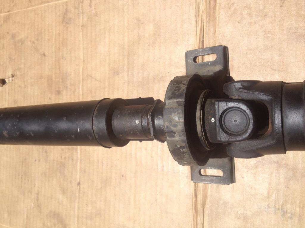

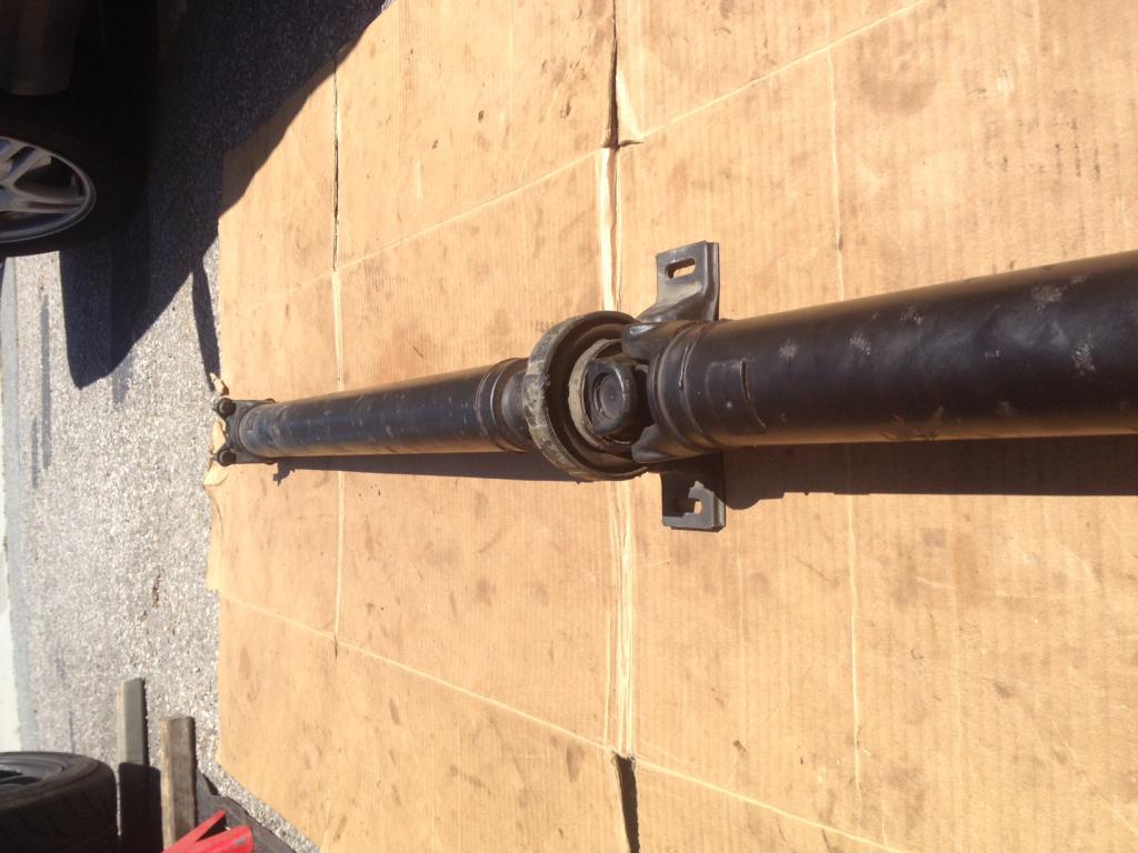

          got the driveshaft back out, the white dots for lining up the two halves looked a *tiny* bit off. i tried to reclock, but the splines are pretty wide, so it's either off one way or another.
          the u-joints moved freely, no binding at all. i read somewhere last night that the u-joints should be aligned in line with each other? as well as the paint marks? it looks like one or the other on my driveshaft. they can't both be aligned at the same time. i took some pics, will try to upload soon.

            some pics of driveshaft and alignment marks
            sorry they're so massive, i'm new at this.

              ok, so i pulled driveshaft back out, again, and re-inspected the CSB and input bearing in the tip of the shaft (lolz) and they looked just as good as the new ones i ordered. since i didn't want to replace good parts, i separated the driveshaft, aligned the u-joints as best as i could, and stabbed it back in.
              i took the car for a short drive and it doesn't sound like the driveshaft is going to punch it's way through the floor any more. hopefully it was just the shaft being mis-aligned.
