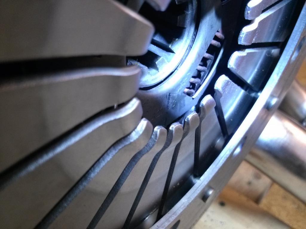

    Hey guys, I am toying with the idea of using a sprung disc from a single mass flywheel E30 setup, with an M3 Sacks pressure plate and chromoly single mass flywheel. My question is, does anybody know how far in the diaphragm tines deflect? I have a hair over 3/8s of an inch, before the tine comes into contact with the dampening springs on the disc.
