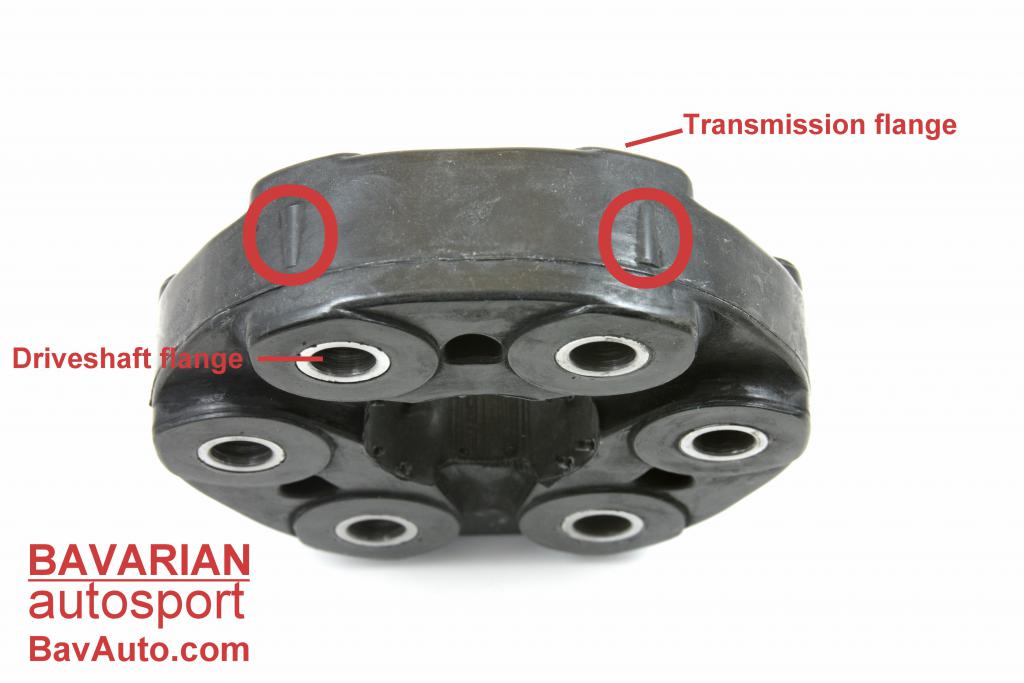

              Whoever installed your guibo put it on "backwards", you can see the arrows aren't lined up properly. Also make sure the shop installs the firewall grommet's for the clutch master feed line and clutch master hard line. Can't tell you how many times people fail to install them while doing a manual swap. Nice mtech btw, love them in red.

                Thx for noticing. I told that to the guy I bought the transmission from a few months ago. I knew we were gonna replace it once I got it to the shop so I just never took it off.
                Matt from EuroMpire texted me an update just about an hour ago saying that he's putting on the new one we got. I reminded him to install it correctly (although I felt like I was preaching to the choir).
