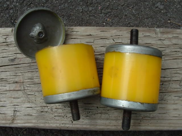

    Hi Terry.
    My 2002 racecar had poly motor mounts for 4 years. Which is why I elected to install a set on my e30 M3. The first set I ordered was from AKG. I returned them before even installing them. They were a blob of polyurethane with a long bolt going thru them. Bad design for street or race. Then I ordered a set from Ireland. The first set lasted 2 weeks. One of the cups delaminated. Then, I installed a second set they sent me, and it still is fine after 2 months and several track weekends (I am a BMWCCA BMWCC and Audi club instructor). I volunteer to test a set, and could even distribute them in Canada if you need some push up North.

      After having the S14 molds built we now have Polyurethane Competition S14 Motor Mounts to go along with the Nylon insert version. Nylon version is race only, whereas the Poly version is more street friendly - but still much stiffer than stock. These cannot "delaminate" like other designs or the OEM mounts. They were built to have the same height as a compressed OEM mount.
      The Polyurethane version has a Shoreline 85 A durometer and uses the same design as our extremely popular E36/46 Competition Motor Mount. Cost is $199 for the pair.
