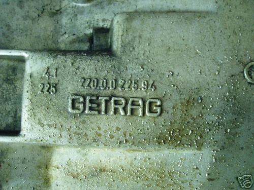

    Transmission ID please.
    Says it is a 5spd from a '95 e34, but I not sure (I'm sure it is a manual, unsure of the Getrag Model).
    bmpr stkr: real racers go left and right... so tru
  • payney8
    • Jun 2007
    • 899
    hmm... any more pics? almost looks like a 260
    • Herb
      • 430
      It should be, but the numbers ^^^^ are throwing me off.

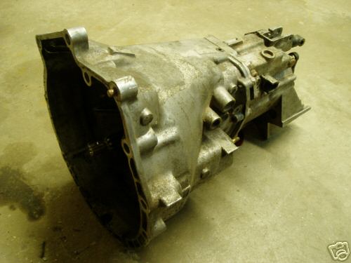

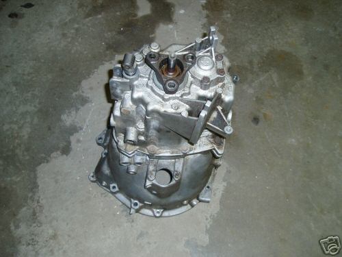

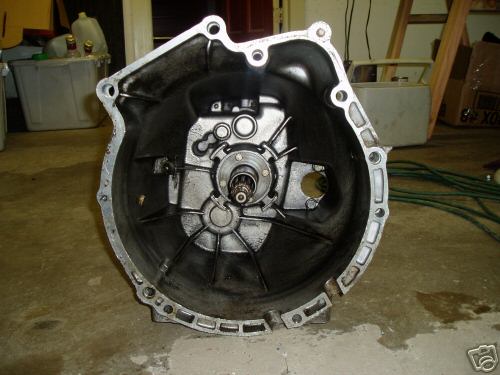

        Can you post a larger pic? The whole trans? Any other markings?
        • Herb
          • 430
          More pics.
          • matt
            • 3732
            Not a chance in hell it's a 260.
            Looks similar to my S5D 250G, but I can't be sure. There are no BMW markings on the trans?
            • payney8
              • Jun 2007
              • 899
              yeap that deffin isnt a 260 looks very similer to the 250g as stated b4
              • Herb
                • 430
                In my confusion I agreed that it should be a 260 (m20 motor), but the tranny is suposed to be from a '95 which should make it a 250g.
                • Herb
                  • 430
                  Got in contact with the seller again and he found the vin on the tranny. wbahd5323sgb37753 - plugged it into realoem and....... 9/1994 525i sedan m50 USA MANUAL. Should have the tranny by next week, and as a bonus it comes with some of the parts needed for the tranny swap.
