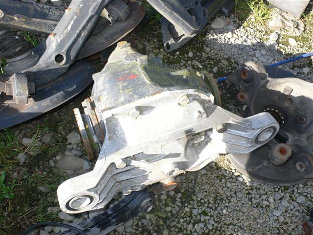

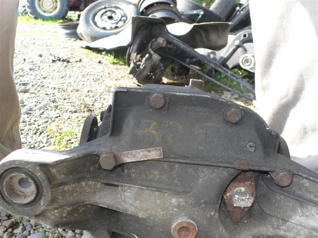

            So these diffs (think from e36s?) I can use? What im wanting to do is change my 3.73lsd to a higher ratio like a 3.15 to suit my v8? Can i change over the internals ? one of these diffs is a 3.15

              Why not save the effort and get a 3.25 from an E28? You can also get a 3.07 out of a euro 635.

                Its just i can get these diffs for nothing.
                So all i need from the e28 diff is the internal 3.25 ratio? and use my lsd stuff? id get it done by someone whos nos what they are doing dont worry lol
