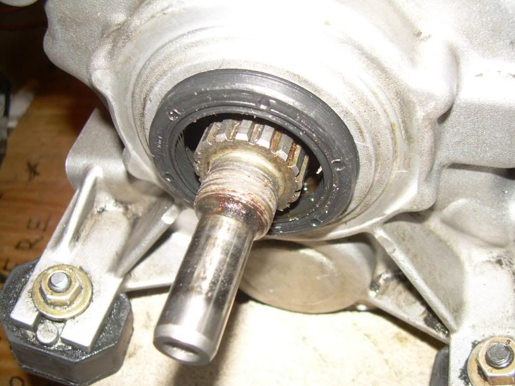

    Tranny Output seal - stuck
    I've got my tranny all nice and removed, trying to replace all the seals. The output seal just pretty much fell apart as I was removing it. Now there is rubber stuck in the outer crevice that I just can't seem to get out. I've tried burning it out and I've tried using a little screwdriver to scrape/pry it out, but this seems to be taking out more metal than rubber.
    Any ideas or advice?

    harden dentist metal pick, work very slowly and carefully so as to not scratch metal
    thats all i can think off.

      Good tip. I got some day from pep-boys and they seemed to do the trick. I think I have gotten 99% of the old rubber out.
      Now, my problem is the new seal doesn't seem to fit at all. This is as far as I could hammer it in:
      And right after I took this picture it fell out. I'm confused! I have hammered it in well, there just doesn't seem to be any room for it. It fits perfectly aside from that.
