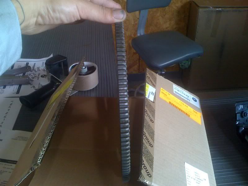

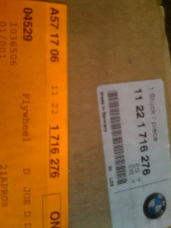

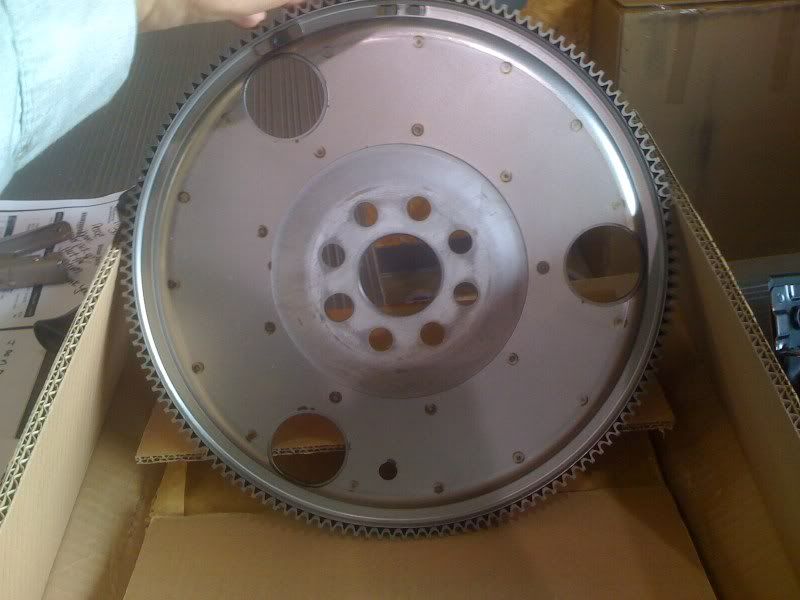

                  so about my above post, i was wrong. so are all the write ups i have found.
                  88-91 325i Single Mass Flywheel BMW PN: 11-22-1-716-276
                  this number above is the following part;
                  somebody please help me find the right part number.

                    Holy shit... I'll look into this and try to figure out what the problem is.
                    It's possible that there was a superseded number that overlapped but.. hell I don't know.
