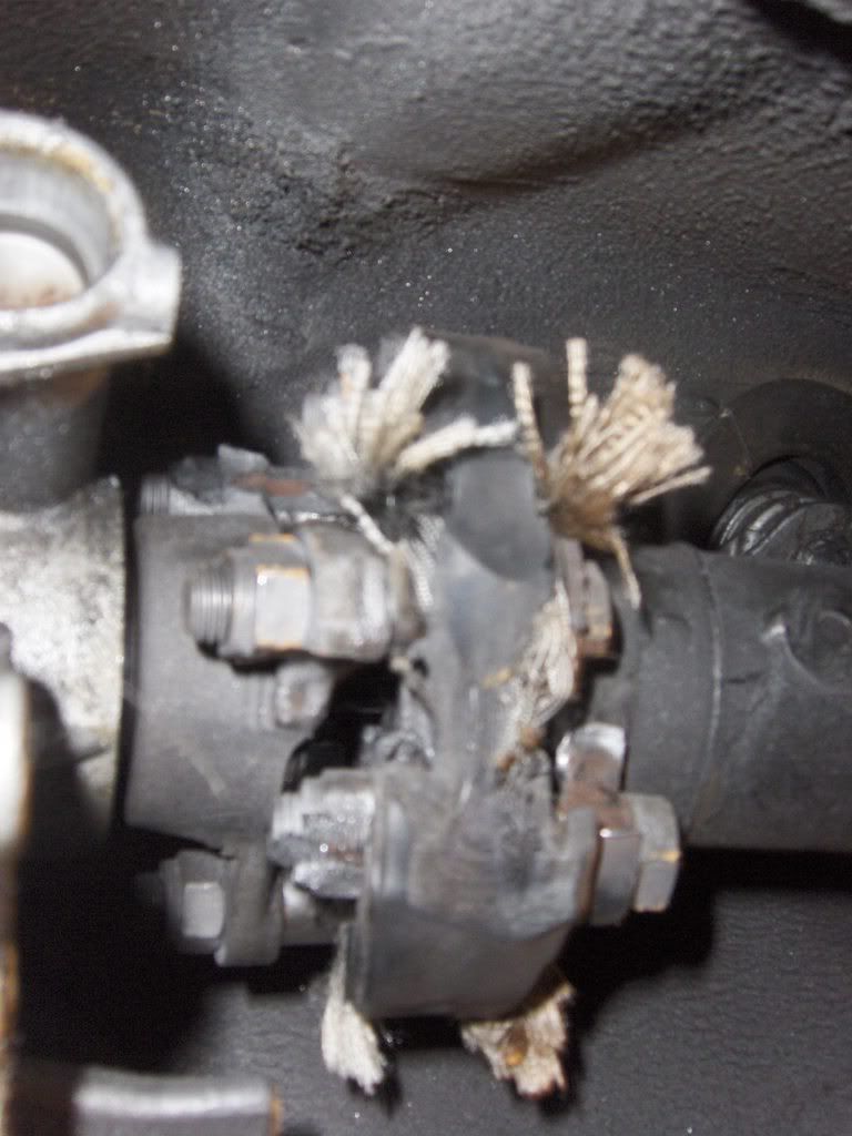

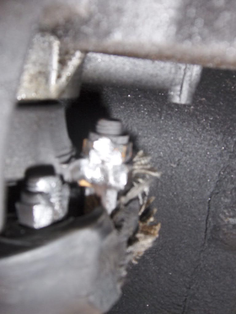

    Hey guys, this is jimmyboy, with the M3. I forgot my password on my other name, so yeah

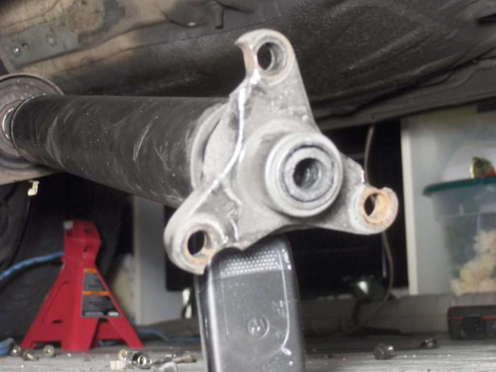

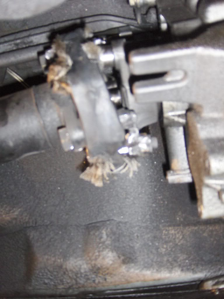

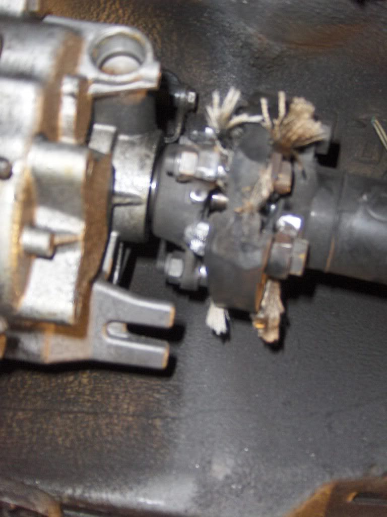

    Anyway, my driveshaft is FCked up! Check it
    Sorry about the "quality" of the pictures
    Hard to tell from the pics, but it looks like the output shaft is damaged? And the rubber u-joint...

    Can't tell if the output shaft is damaged from the photos but the guibo is a cheap and easy thing to replace. Good thing you caught it when you did. Those things mess All kinds of shit up under there. Looks like you caught it just in time. Anothe few hard accelerations and it would have been destroyed.
    Good luck with the repairs.

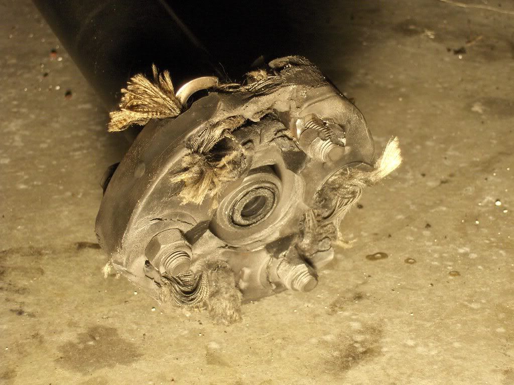

      Where do i get the guibo at? I've never heard it called that.
      • StereoInstaller1
        GAS
        • 22679
        Buy one from the dealer: a little more money, but much thicker/stronger than aftermarket.
        Make sure you install it correctly, there was an arrow on mine, but not on the aftermarket one I destroyed.
        GL!

          Any other issues that you guys see?
          which way does the arrow go?

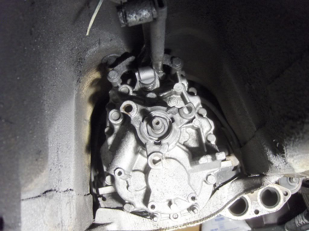

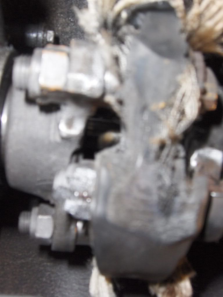

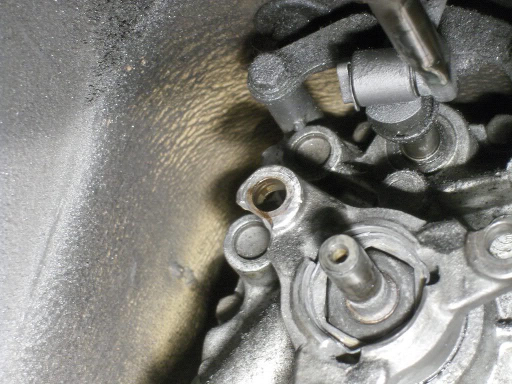

          here are some more progress photos

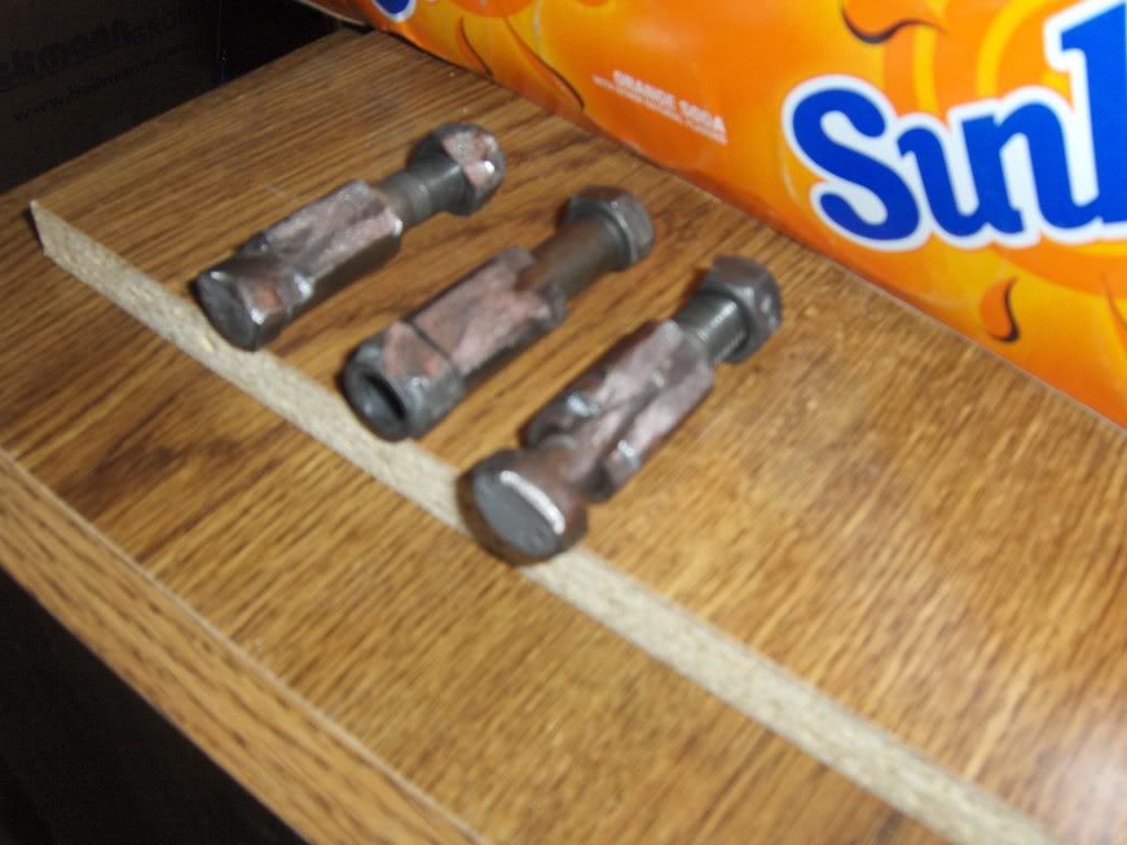

          where do i get these sleeves at?
          • StereoInstaller1
            GAS
            • 22679
            Fuck, man, that had to be making some shitty noises for quite a while...you trashed the driveshaft and the output flange!
            Put the new guibo in so you can drive it, but prepare for buttraping if it breaks.
            The "sleeves" are part of the guibo!
