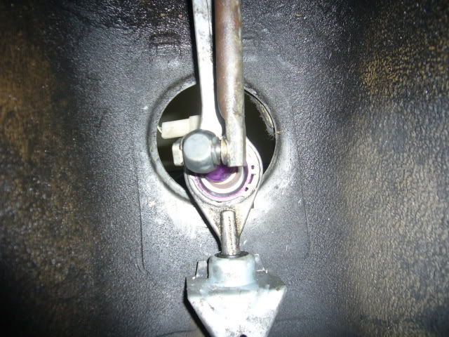

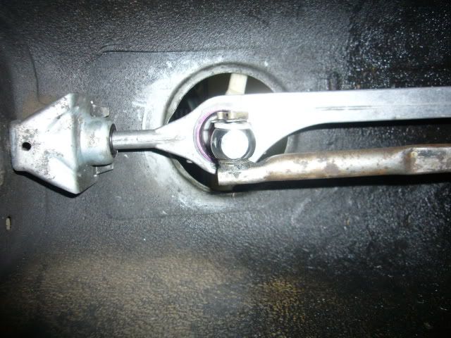

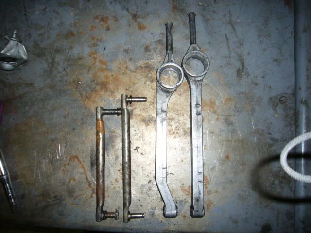

              I took pics today. Thanks I did what you all said. Like I said the motor and trans were in it when I got the car.
              Both side by side. The shorter is from the donor.
              Old linkage
              From donor trans
