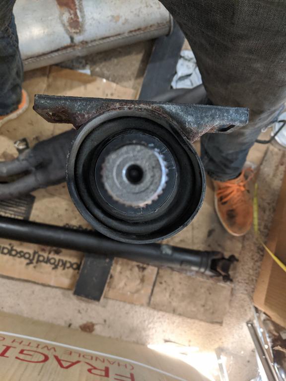

    I discovered the original driveshaft to have a very minute amount of play in the rearmost u-joint, my transmission mounts to both be severed, and the center support was no longer round?
    Click image for larger version  Name:	49783281022_1417c4d2b2_k.jpg Views:	0 Size:	56.3 KB ID:	9918288
    This is mysterious to me, it doesn't seem like something that would've happened on its own...I can't decide if someones just goofed it up when installing it, or if this was an intentional move to align the driveshaft in a different way...
