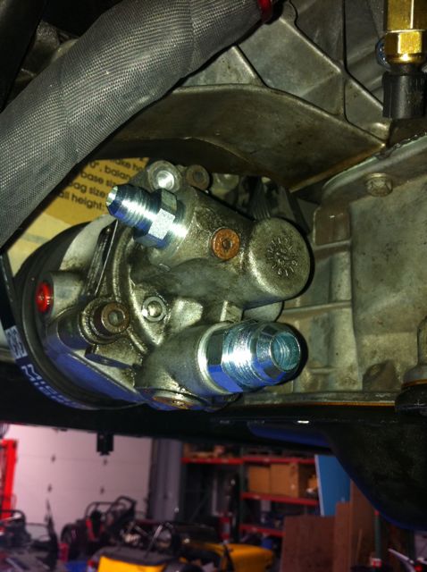

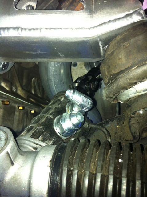

                    Attached are a couple of photos with the Metric Banjo <-> JIC/AN conversion fittings installed in the rack and power steering pump.
                    -Bruce

                      I couldn't find any steel adaptors like you used that had a wide enough shoulder to seal with a crush washer like the factory intended for the high pressure line. The ones shown will work fine on the low pressure lines with stat-o-seals but I was taught that they won't take pressure well. Mine on the high pressure ports look more like below, and still use the factory crush washers and hollow bolts.
                            The Parker fittings have an o-ring, and a slightly oversized backing washer. The washer squeezes the O-ring between the face of the port and the inside diameter of the washer. This approach effectively creates an ORB port. No crush washers are used.
                            Here are the Parker part #'s:
                            14mm x 1.5 Port (pump output and top of rack): 6M14F8OMXS (straight) or 6M14C8OMXS (90-degree elbow)
                            16mm x 1.5 Port (lower port on rack): 8M16F8OMXS (straight) or 8M16C8OMXS (90-degree elbow)
                            18mm x 1.5 Port (intake on pump): 10M18F8OMXS (straight) or 10M18C8OMXS (90-degree elbow) <--90-degree won't clear back of pump
                            For the tandem vane pump, you'll need to plug the ABS output: VSTI10X1EDCF
                            -Bruce
