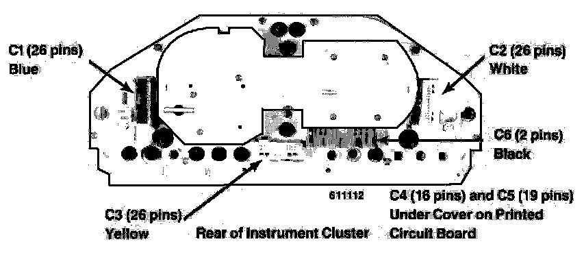

                  Connector C2, pin 10, wire color BU/YL on the back of the instrument cluster goes to pin 42 of the 404 DME. This is for my setup at least. See attached picture for C2 location.

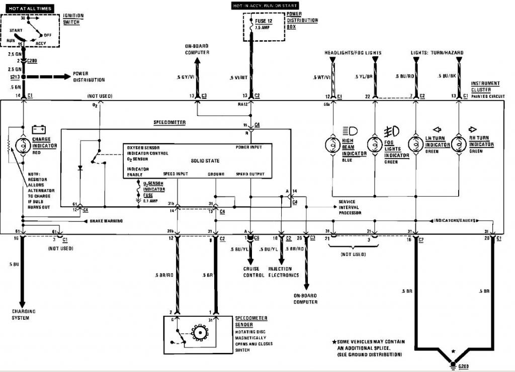

                      I’m assuming that you are using a M60B40 black label 404 DME. Pin 14 (gr/bl) DME is MAF ground, and pin 42 (blk/wht) DME is Speed signal. Run a wire from pin 42 on the DME to pin 10 on connector c2. Or the signal can be run through connector c101 pin 14 to the DME. Pin 26 of C3 (br/rd) goes to OBC with the speed signal. Here is a diagram of my cluster:
