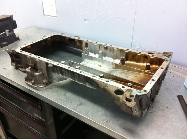

                      • noid
                        • 1535
                        Found them:
                        Very cool, wasnt he using a e36 rack in his e30? Bruce said "At the front edge of the cut, the height of the pan was reduced about 7/8". The new pan "floor" still maintains a bit of downward slope for drain-back to the sump." I wonder how much effect the e36 rack in relation to an e30 rack had on how much needed to be removed.
