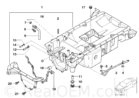

                          You may be able to use a combination of the top section of the BMW Z8's oilpan/pump merged to the bottom of the X5 pan.
                          The Z8 had a centrally mounted sump area, and may lend itself to converting to what you want with some cool surgery.
                          Or not.
                          But last I checked there were several pans in the inventory.
                          Alex.
                          I'm guessing he deleted the post.
                          The Z8 sump obviously won't work in the AWD application, and the RWD sump works just fine in a RWD E30.
                          However, the Z8 sump looks like it would be useful for an E36 S62 swap.

                          Real OEM:
                          It *DOES* appear to retain the active sump...
                          Food for thought.
                          Edit: The list price is only $1200...

                              I deleted it after looking more closely at where the pump is actually located, and realizing that my memory was fallible.
                              I thought that the pump location lended itself more to the AWD platform, but looking more closely, realize its going to interfere with the same space the axle has to pass through, so you really need a front sump, BLOCK mounted oil pump to pull off the AWD aspect.....
                              Hence, I just deleted the post.
                              Also, a reasonable inference, I was looking at the Z8 architecture to see if it might lend itself to E36 use, but its far from optimal for that, even disregarding the price it, it still doesn't add up to a plug and play rear sump situation for the E36 crowd. To preserve the original placement of gearbox to chassis, the space alotted to the sump is actually quite small for these V8 engines.

                                For AWD, the only pan that's a serious contender is the X5 pan... nothing else will mount a differential.
                                There is a post on Bimmerforums with pictures of an E36 V8 (actually an S62) built using the X5 pan without the diff. It actually looks like a really good fit.
