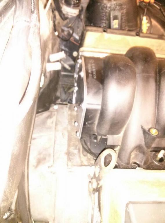

Now today at work i built a rear block off plate for my intake manifold. I will be adding vacuum ports later as i get everything sorted out.
I'm thinking of also mounting my idle control valve on the back plate to cleanup the throttle body area. I'll also be blocking off the front port. My crank case ventelation will be handled by a "stock car" style catch can/breather with a return line and low pressure valve.

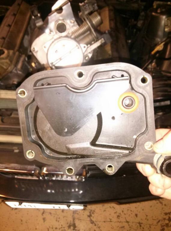

What's the reason for the block off plate? What did you do with the internal pipe that connects to the oem piece inside the intake manifold?Mtech1 v8 build thread - https://www.r3vlimited.com/board/sho...d.php?t=413205

Aww. Me thinks the same thing till i realized that all 3 of my intake manifolds were different.
So i pulled them apart to see how they work.
My early model b30 manifolds with velocity stacks "has no inner tube stuff" check the 2nd pic its the b30 stock back plate with no application for the inner tube stuff.
Now for my other too 97 b40, and my 98 b44
Manifold appear to be the same inside.
Front
Back
Now as to why am i doing this. 3 reasons, shotty and pointless in all regards except cause i can.. :-P
1. Make more room for the swap at the firewall.
2. Cause i ditched all the smog crap.
3. Adds performance. Oil vapor in your burn tend to give a lean burn.

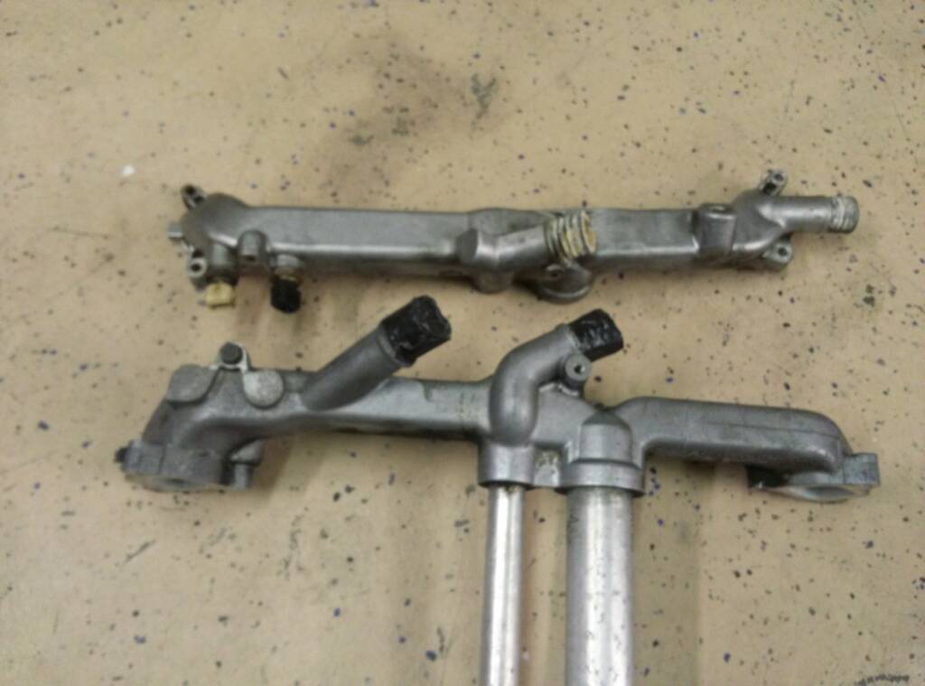

Ok take point in this picture. My motor is currently in the forward position till i finish modifying my manifold and water cross over tube.
Plus i've noticed all the v8 boys seem to have an issue with the water tube so i'm trying to think out side the box and ditch the bs problem of the water hoses. And seeing that i'm a hell of a bad ass welder / fab guy i will be modding all this $hit so i don't have any issues with this crap...lol

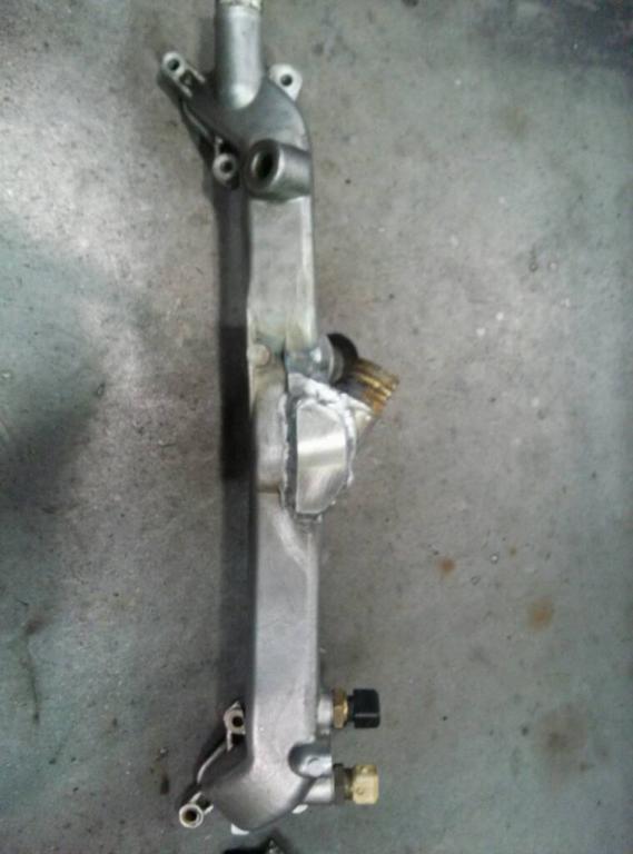

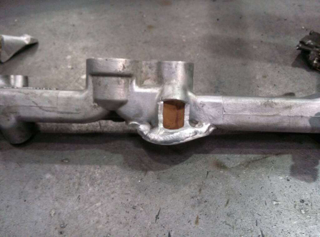

Ok so finished the water tube build and think its the bees knees
It turned out really nice..
