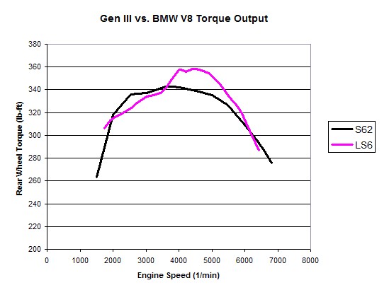

            Originally posted by Insanity
            Yes, but it doesn't matter. If your 7L of displacement is only operating at 50% VE at a comparable RPM level, then the fact that it's 7L doesn't really matter, now does it? Displacement in and of itself means nothing. F1 is really a perfect example of it.
            In a world where most VEs are very similar except for maybe the very edges of the powerband, the power levels ARE NOT night and day.
            If you compare the torque curves of both the LS6 and the S62, you'll see that the LS6 is down on torque at lower rpms, but overtakes the S62 at above 3500 rpm. I've attached a dyno plot of both vehicles, the data taken on the same chassis dyno at the same facility.
            The S62 IS 1L smaller, but you can see that it has a slight power advantage at higher RPMs. Not the best if you plan on having a race where you keep it below 3500, but who does?
            You can see by the torque curves that both engines are flow limited at upper engine speeds by the way the curves die down quickly.
                First, no it will not take much effort to get a better powerband out of the S62. Hardly any at all. The s62 (and all BMW v8 ) camshafts are designed for smooth daily driving operation in a luxury car. The LS/LTx camshafts are NOT. Same thing with the manifold. Mess with the intake manifold and retard the cams on the s62 and you're going to see a drastic high-end improvement, end of story.
                I didn't say that it would take EFFORT. I said it would take MONEY. Schrick cams are $2100 alone. Installing different intake trumpets and making intake modifications for better flow would all cost an arm and a leg. The installation itself would be fairly simple and wouldn't take much effort!
                Nowack has a power increasing program just like this, where they make mods to the entire intake tract, the heads (for increased flow), and sport camshafts. They have obtained 500+ hp from the S62, and increased the redline to around 7700 rpm. They even have a stroker version that displaces 5.5L.
                Also, your graph really only serves to prove me right about the s62 being set up entirely for a luxury car, and ALSO proves why it gets much worse gas milage than the LS, because while 1000-3500rpm doesn't mean shit in a race, it means EVERYTHING to someone driving around town.
                I don't recall telling you that you were wrong in assuming the S62 was set up for a luxury car? The table-like flatness of the torque curve would indicate that it is made for effortless driving around town. Of course, the LS6 is set up fine for beating around town as well. It might have a slug of torque starting around 3500 rpm, but it has PLENTY down low as well.
