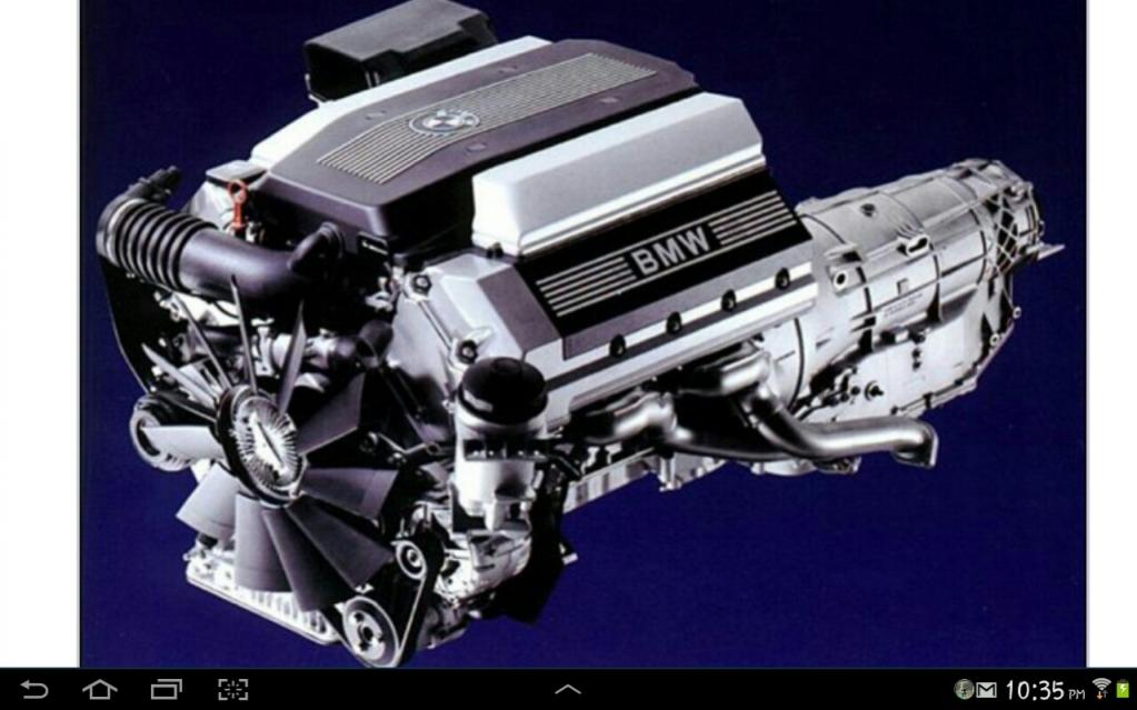

    you mean something like this
    cause this is whats going in my other e30:up:
