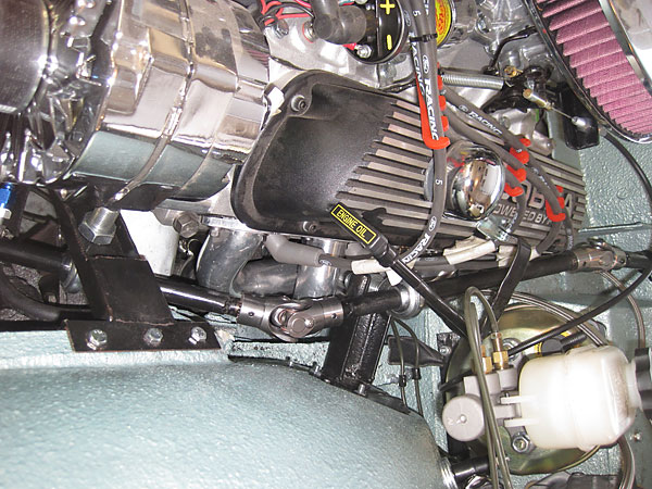

          anybody try u joints and a heim in an e30
          That would work but, it wouldn't be smog legal here in CA. That's my issue.
          Has anyone tried adding in u joints and a heim to the steering shaft in an e30 like this ? I wonder if there would be enough room?
