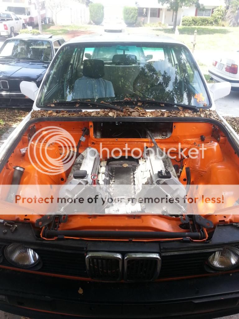

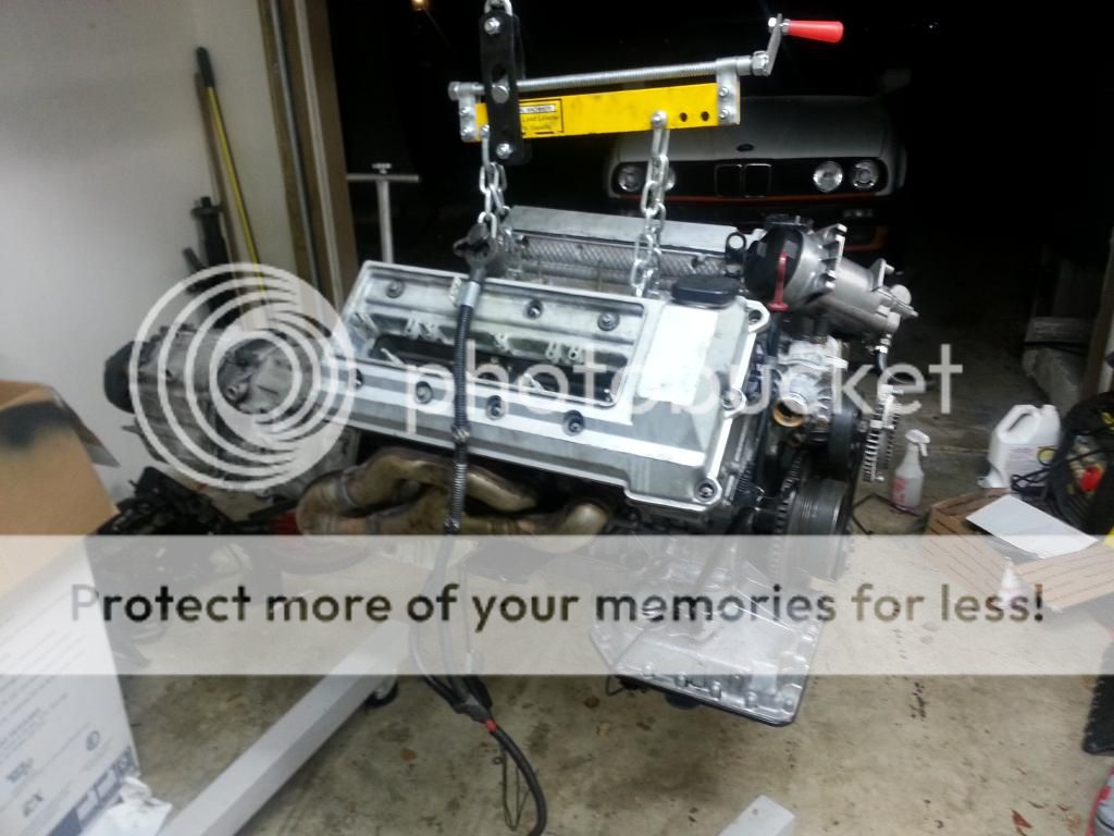

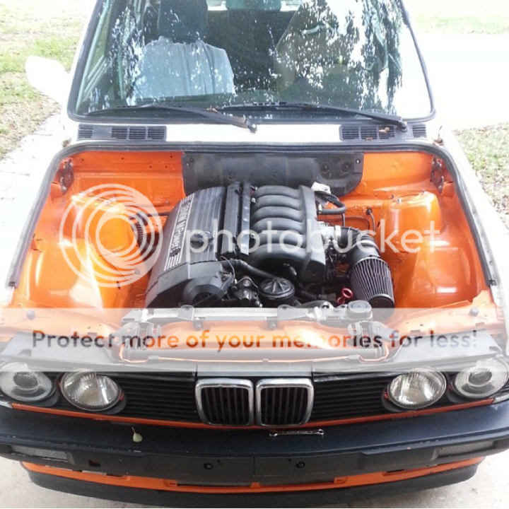

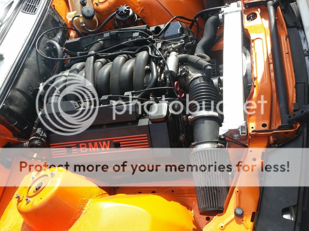

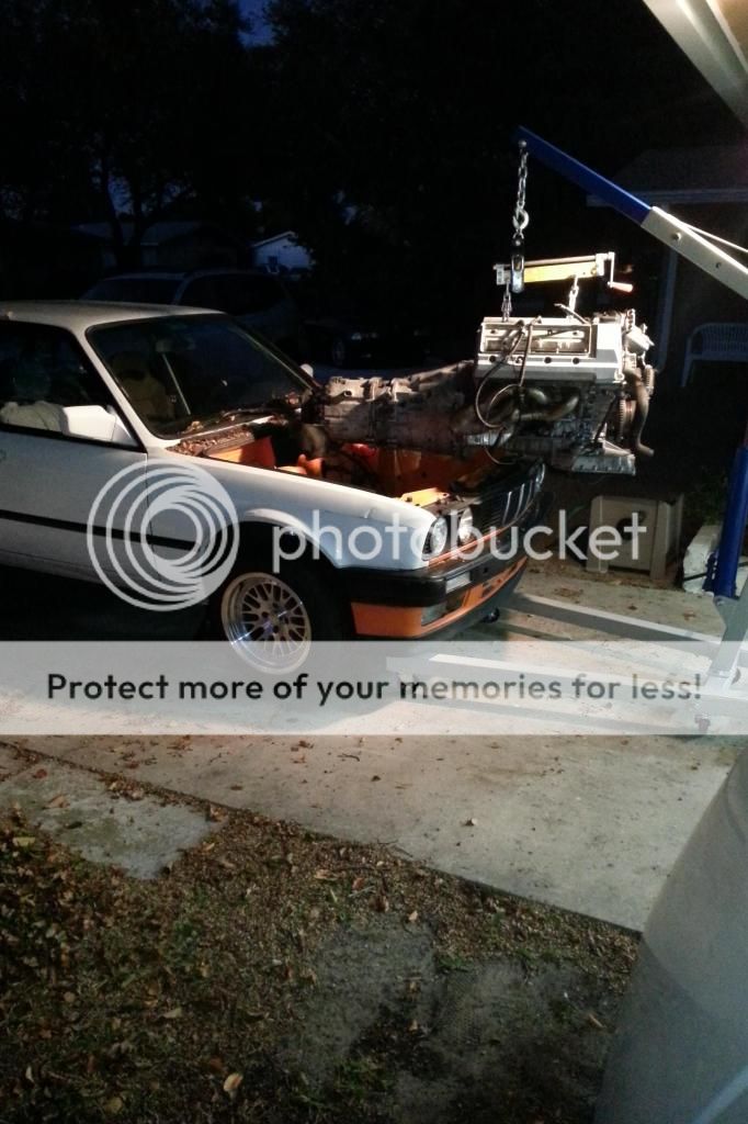

    obd1 m62b44 finished swap.
    Hello this is my finished obd1 m62b44.
    98 540/6 engine and trans
    obd1 converted
    SSSQUID Tuned
    jb racing LWFW
    stage 2 f1 clutch
    modified e30 drive shaft with 6 speed input flange 160$ at local DS shop
    modified manifolds
    garagistic engine arms
    Z3M aluminum radiator
    Thats all i can think of for now.
    started with s52
    the engine
    going in the first of many times
    the e30 the the hood up has my old s52
    my daily of the time creeping
    set in
    and a picture from the other day, i really need a reservoir
