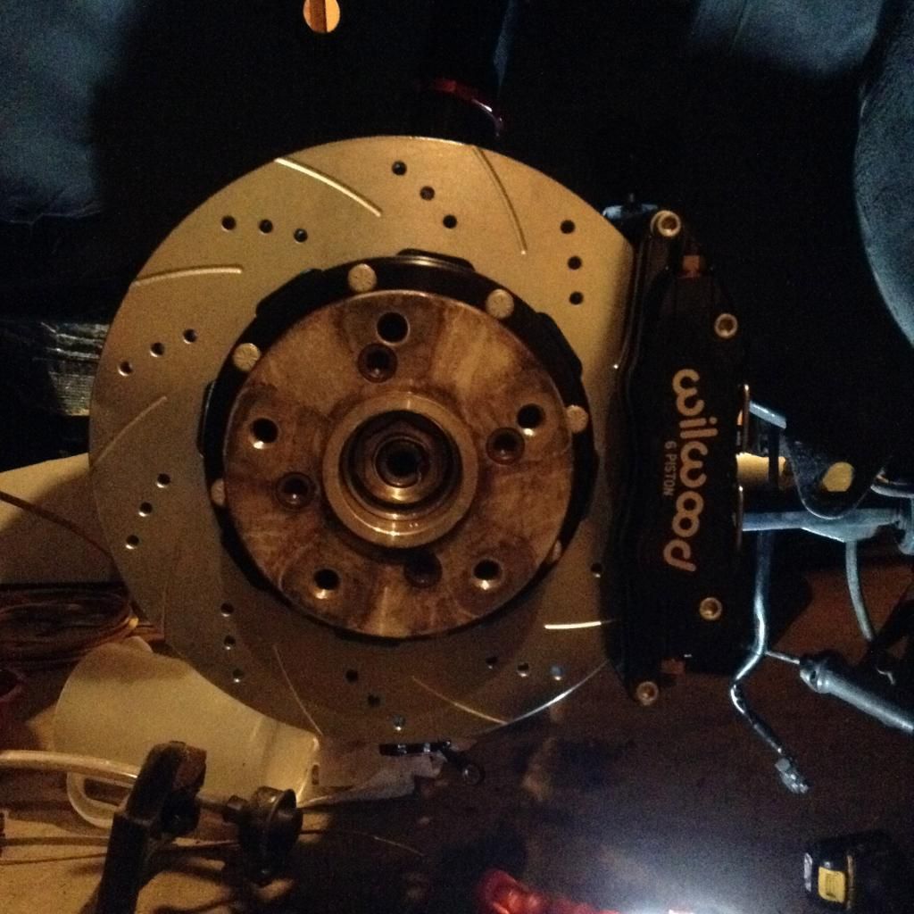

    wilwood 6 piston bbk w/310mm brake rotor

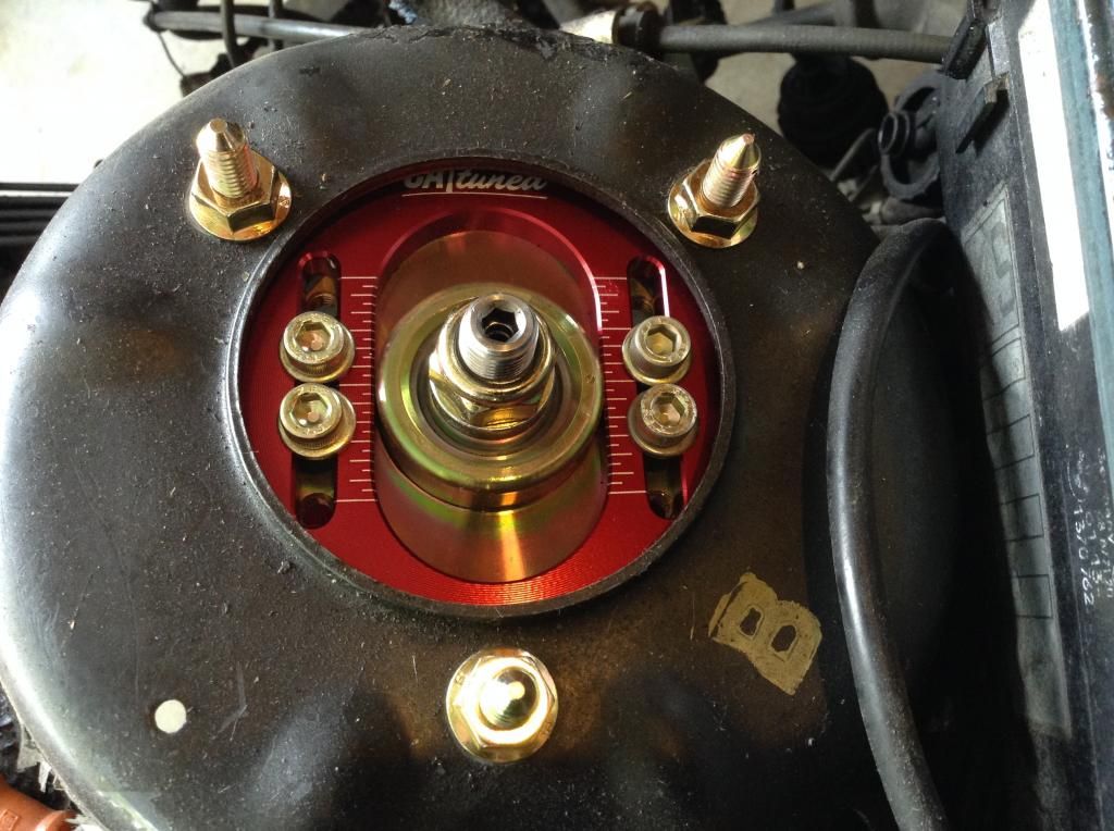

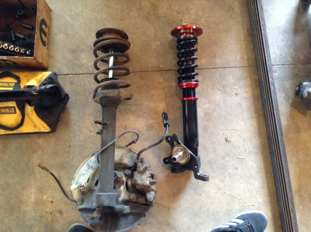

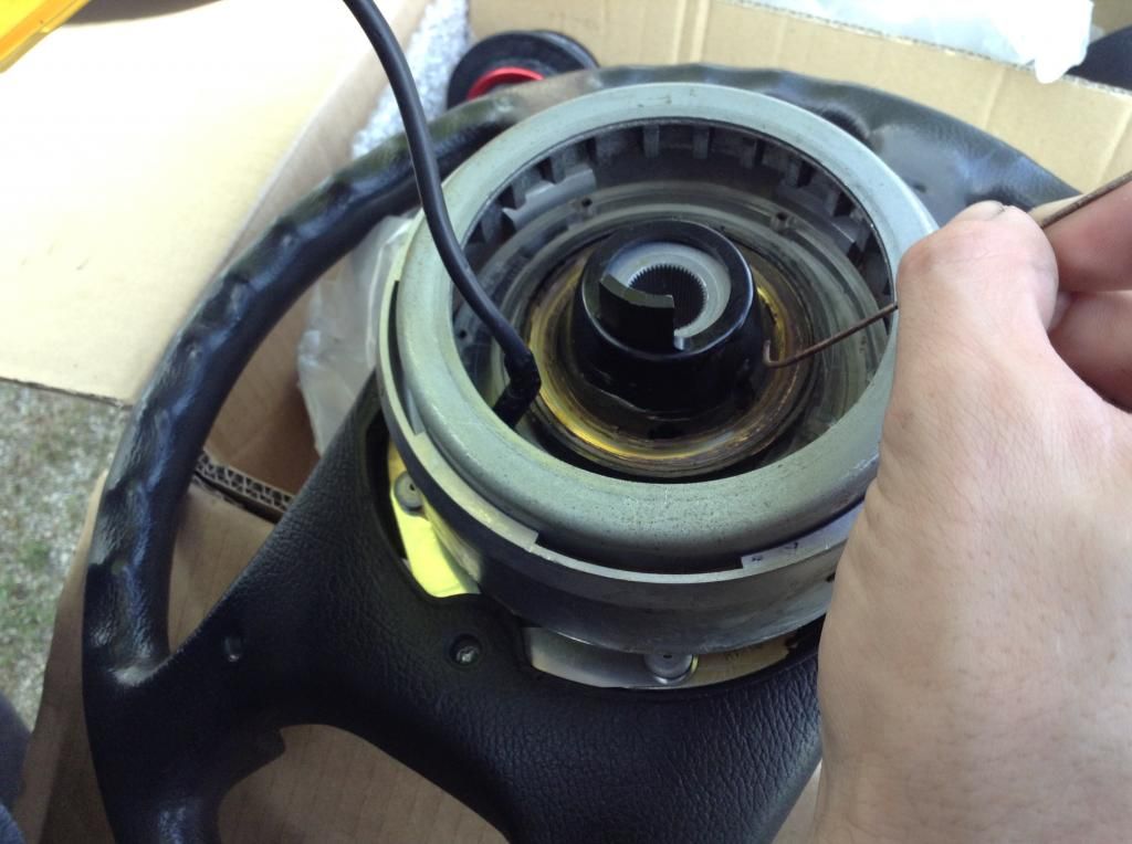

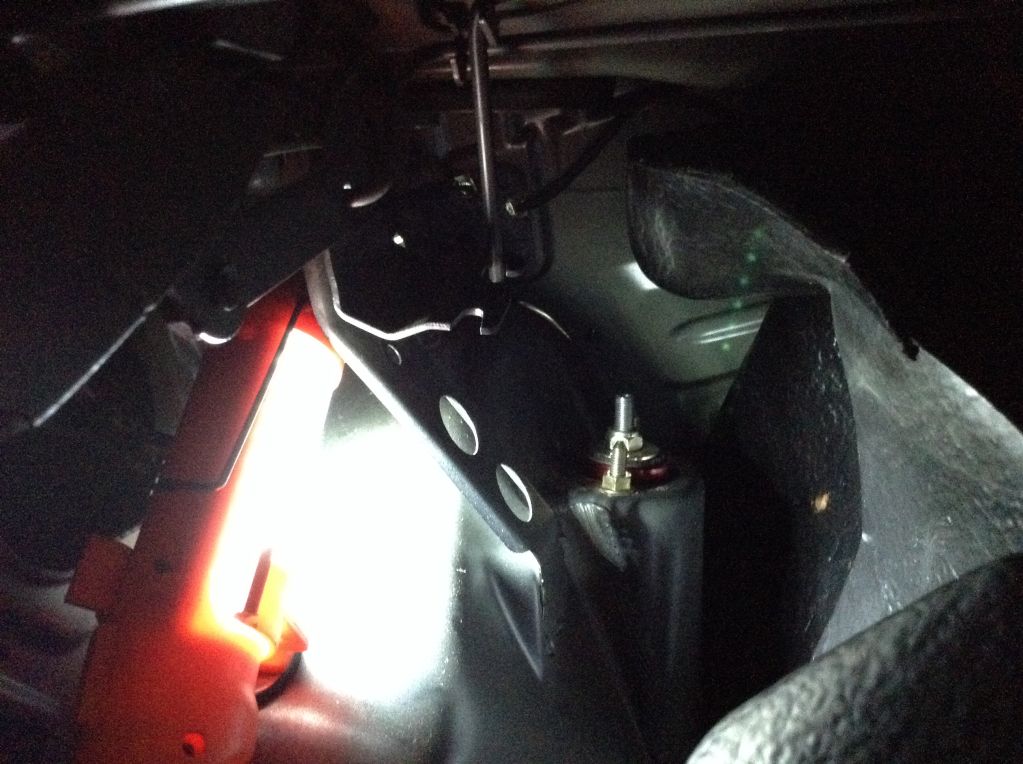

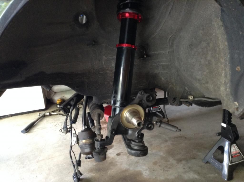

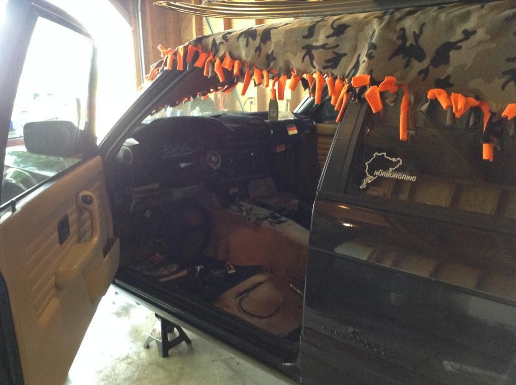

              update put the front coil overs on and disassembled the steering column
              ooooooo pretty
              still playing the playing game on some (a shit ton of) parts
              trying to save the horn !!

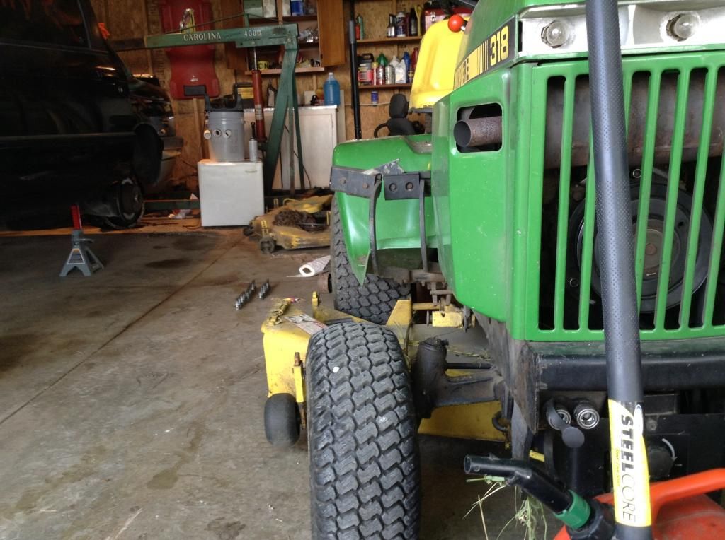

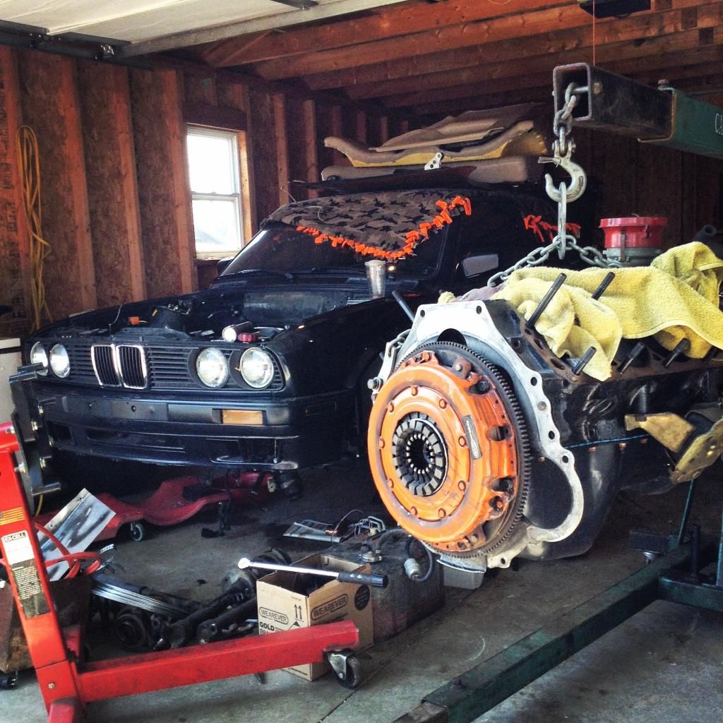

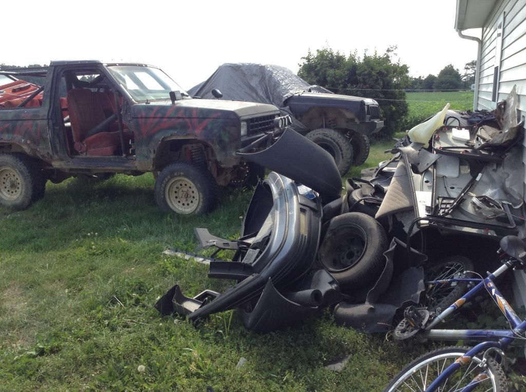

              the junk pile
              some exhaust ideas?
              ill just be here until more parts appear.

                Damn, that's one hell of a back yard... gotta be what, 7 acres? Hard to tell

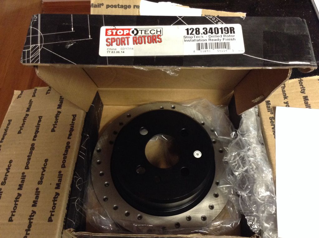

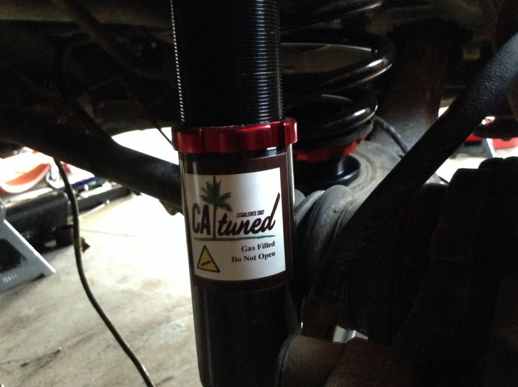

                  Rear suspension from catuned, I mean bc, china**

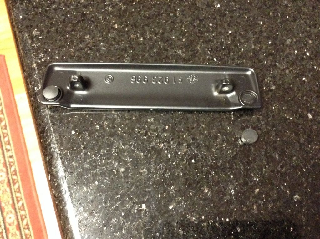

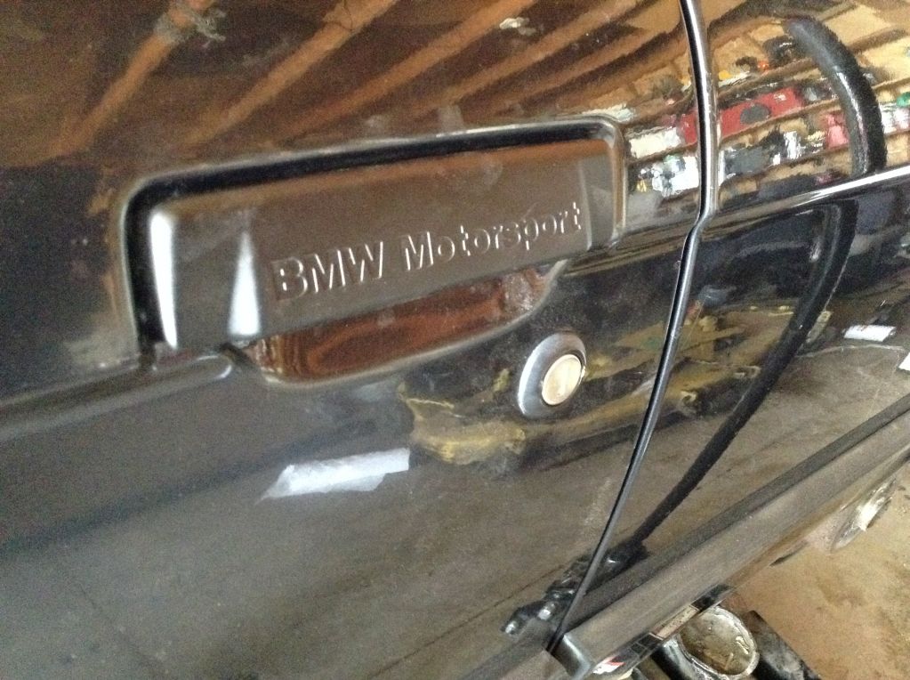

                  New door handles a bit salty but hey
                  -.- it's the little things
                  More from catuned, I mean stop tech

                            I run the same bbk up front and love it
                            Also have the rear 295mm kit in the rear with a wilwood pedal box and 5/8" masters
                            Brakes awesome!
