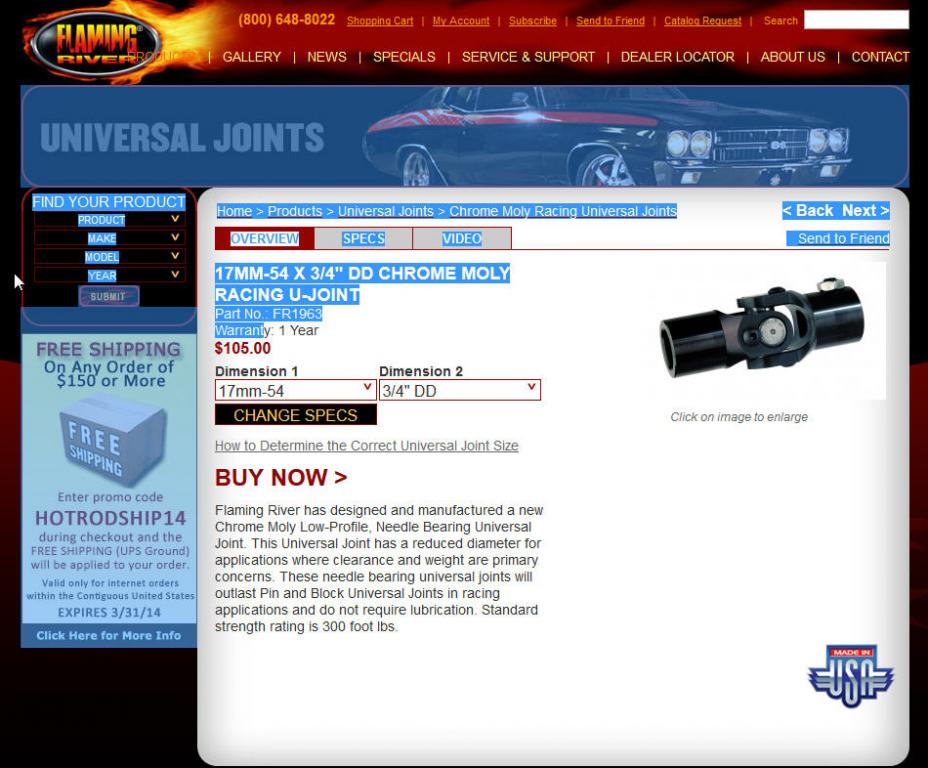

                        We also would use the flaming river u-joints and steering shaft. We would cut the set screws shown in the pic above down to flush with the jam nuts. They may interfere with the exhaust system if left as is.

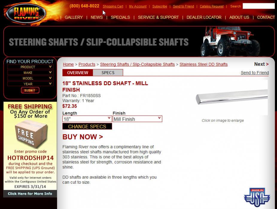

                          You can buy direct from Flaming River the following steering components:
