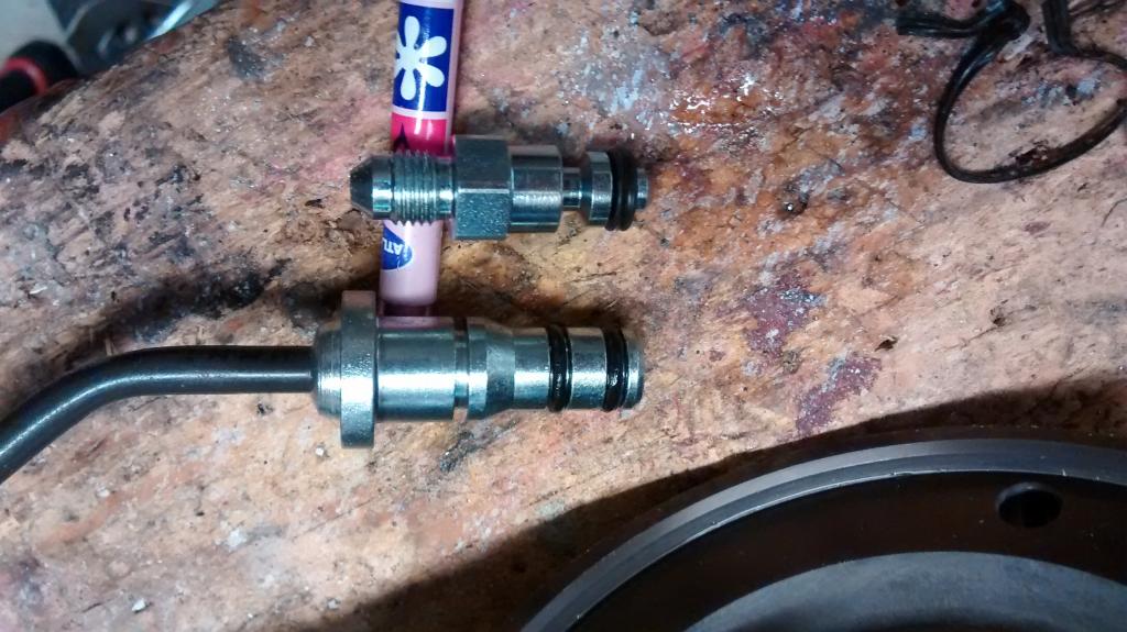

              Well I got the Russel fittings and they are tiny. This is the factory supplied LS7 Luk kit hose. It has the smaller fitting at MC end and the larger one at the slave.
              Hmm.
              This is the connector that fits my TO bearing next to the Russell. I'm not going to see if it fits as the lovely t/o bearing was pre bled from Luk and I don't want to get fluid on it to complicate it's return.

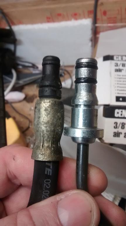

                Dead thread maybe, but wanted to throw an update on this in case anyone runs into the same issue. There are indeed two different slave cylinders configurations (regarding bleeder and feed line) that came on the LS motors. The newer TR6060 have seemed to mostly be the newer style that you cannot find the fitting for.
                Chase Bays offers a great kit, and as of writing this it only works with the older LS1 slave configuration.
                Pic from Chase Bay's site and their kit- you can see that the supply line is fixed using a pin
                Newer slave style- found on a 2010 Camaro TR6060 and also in a new clutch kit for the LS7
                Bleed valve thread (bottom one is newer style)
                Feed Line, same difference as shown previously in thread)
                The only place I've found that has these adapters are Hinson and Tick Performance. There are some ebay vendors that sell the adapter but haven't purchased to try any of them yet.
