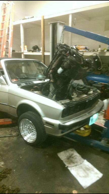

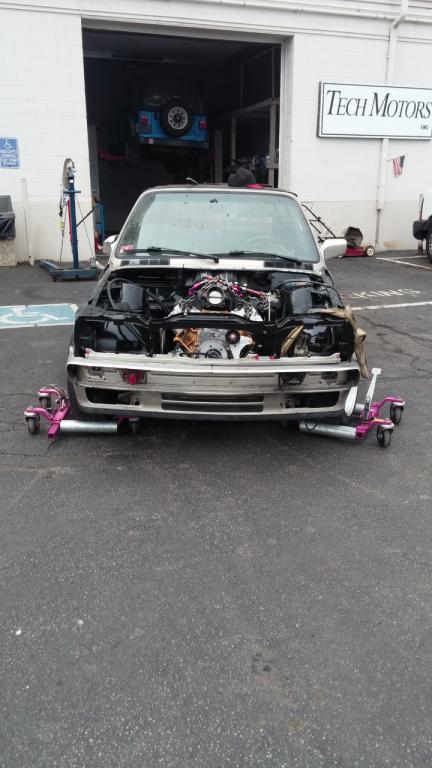

    Me and a buddy of mine are in the process of building his 1988 bmw 325ic. It's kind of a slow build but i will update whenever i can with it. The motor is a 6.0 LQ9 out of a Cadillac escalade. We changed the cam and put a mild one in it. Not much else done to it besides all the bolt on things from the swap kit. The kit is from sikky with the usual headers, mounts, drive shaft and odds and ends. Front sump oil pan and wiring harness.
    The day we pulled the motor out Click image for larger version

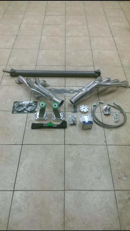

    The kit he ordered from sikky Click image for larger version

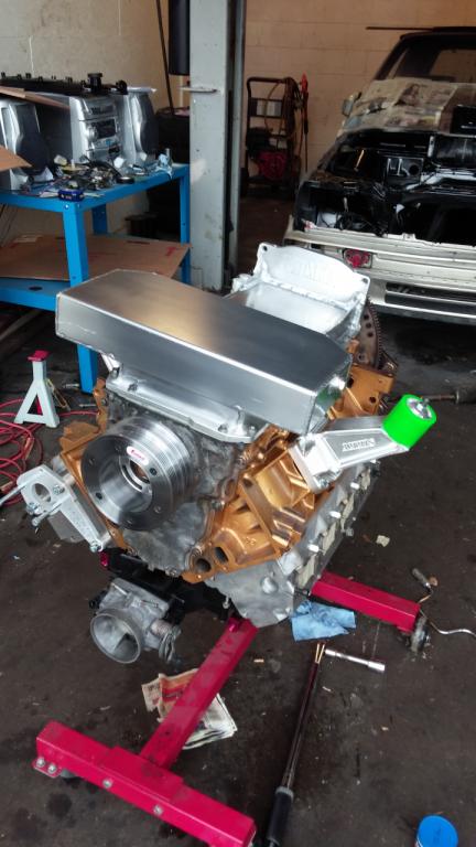

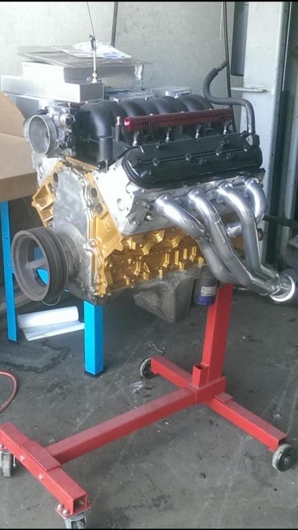

    Painted the motor, put the intake on and bolted up the headers for a quick picClick image for larger version

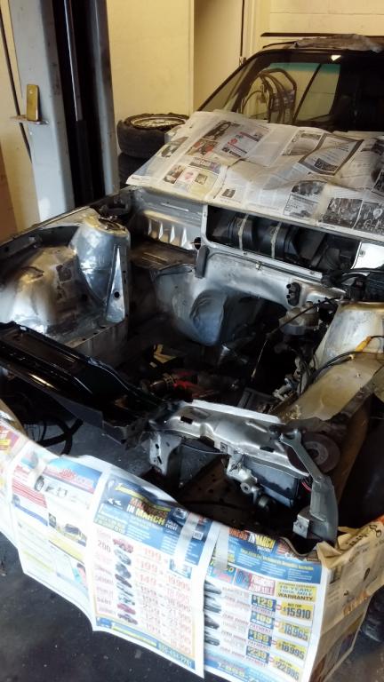

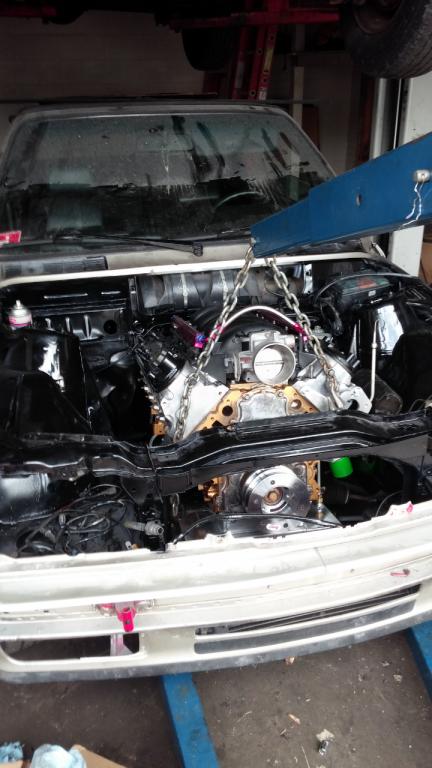

    Decided to sand everything down, remove unwanted brackets and useless odds and ends and paint the bayClick image for larger version

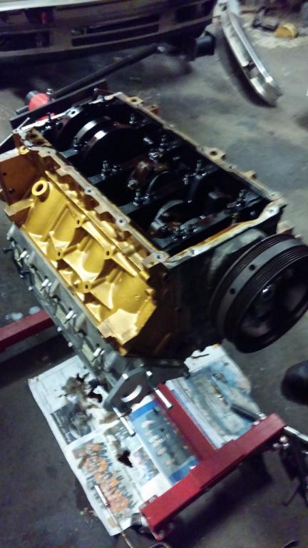

    Got the cam in so started tearing it apart to install it Click image for larger version
    The day we pulled the motor out [ATTACH]97339[/ATTACH]
    The kit he ordered from sikky [ATTACH]97340[/ATTACH]
    Painted the motor, put the intake on and bolted up the headers for a quick pic[ATTACH]97341[/ATTACH]
    Decided to sand everything down, remove unwanted brackets and useless odds and ends and paint the bay[ATTACH]97342[/ATTACH]
    Got the cam in so started tearing it apart to install it [ATTACH]97343[/ATTACH]

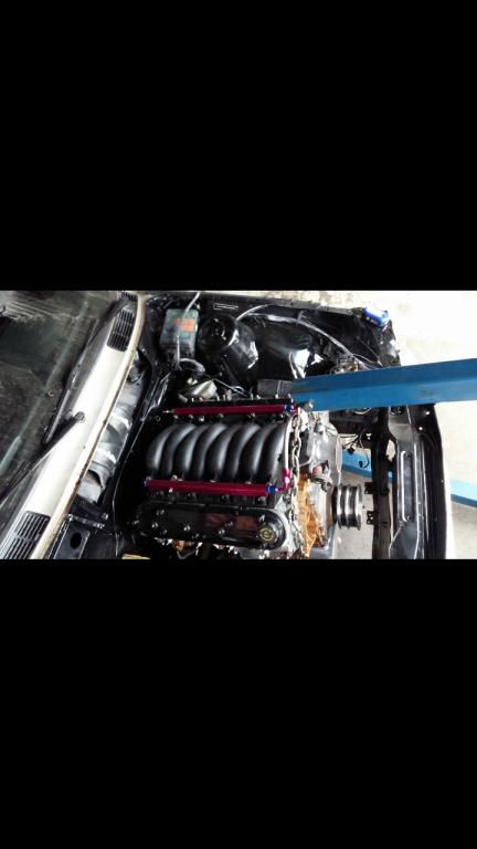

    Got the new cam installed, underdrive pulley and mounts Click image for larger version

    Test fitting the motor Click image for larger version

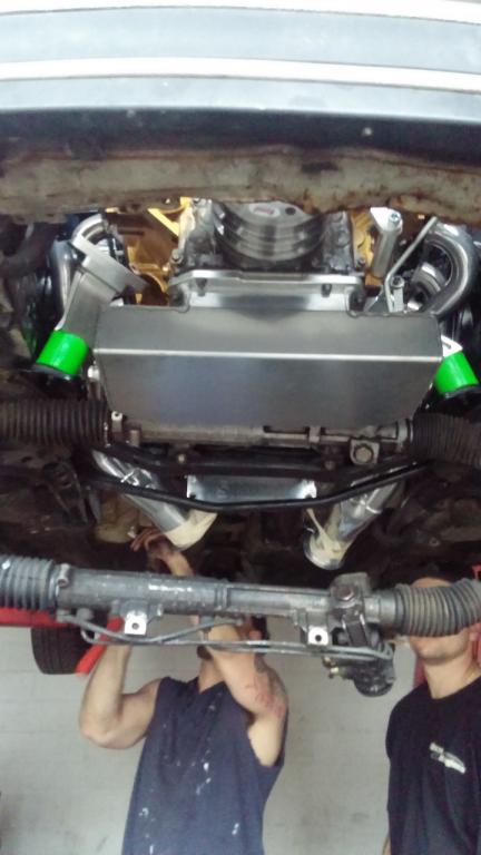

    Got the car up in the air installing the drive shaft and rear spacers...and yes you do see 2 racks attached lol Click image for larger version

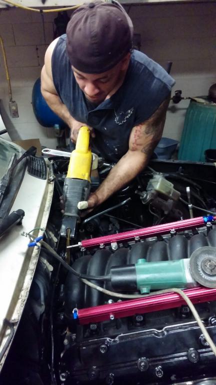

      Fitment issues like crazy...had to cut the heater core hose connectors off for the motor to sit all the way back Click image for larger version

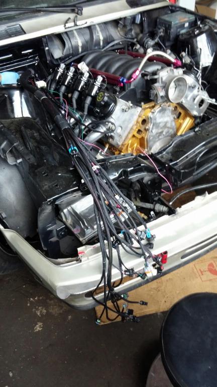

      Got the wiring harness in yesterday finally after sikky sending me the wrong harness 2 times. What a cluster fu*k of wires with only half of them labled Click image for larger version

              I guess you needed to get after market "lollipops" for the control arms so we just unbolted the control arms until those come in and with it being such a tight fit it seemed everything was an issue. We had to bolt and unbolt the headers and engine mounts like 20 times to get it to sit right. And having to bang the firewall back so the bell housing would fit. It's been Crazy but its coming along.

                LMK if you have issues. The documentation should mention stuff like the lollipops, needing an E36 rack, and the heater core hose outlet length.
