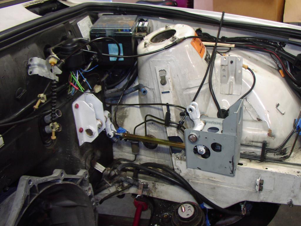

    Hey so my rhd e30 touring has a blown motor and i want to swap in an LSX in there. From a bit of research, looks like no one has done it. Seems like one problem is the steering rack will get in the way of the starter. But they do have starter relocation kits for the LS as such
    Will this work?
    I reached out to sikky and they said their kit will work for rhd besides the hydroboost. Is there any other problems i might run into (besides custom headers) when doing this swap? Thanks

      With a starter relocation like that, you would not have any problems if using a kit like ours. The brake pedal and steering may be on the RH side of your car, but the brake booster is still on the LH side. We used two different header styles for our swap (standard LHD car with starter on the RH, USA side). You would have to simply use the opposite combination of Sanderson headers. Our HydroBoost will fit in as usual.

        Will your hydroboost work on rhd setups? Even though the clevis' are different?
