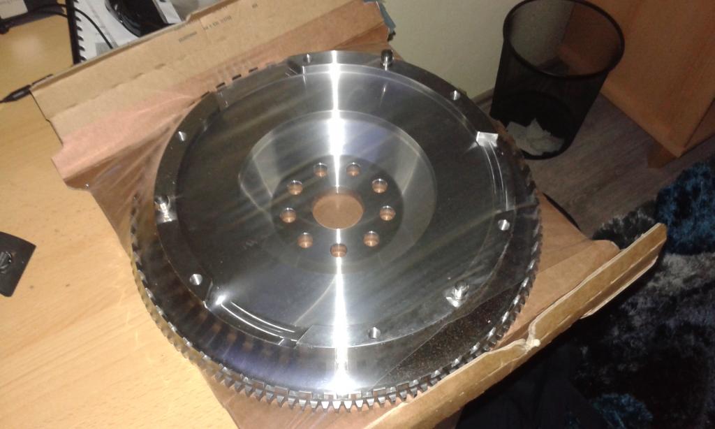

    Hi friends! I bought lightweight flywheel for my e30 m62 swap. My question is what bolts should i use for attach? Does anyone have link for new flywheel bolts? Or does the oem bolts from dualmass flywheell will fits?

      I used stk E30 single mass bolts m60/5spd w/ ttv FW / e36 m3 clutch

        So from m60 5speed oem bolts will fits?
          I ordered oem bolts from e39 m5
