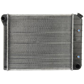

    After a bunch of searching and looking around. I am going to go with the Mishimoto MMRAD-DBP-26
    That radiator might be too wide for the E30 chassis. I think its about 27" between the rails and that radiator seems to be more than that.
    Alpine White 1989 E30 Coupe - LS1/T56
      It should fit a little tight on the height wise, With some custom brackets it shouldn't be an issue.
      The measurements on the MMRAD-DBP-26 is 27" x 19" x 3"
      And for the e30/e36 MMRAD-e36-92 it is 27.7" x 17.8" x 2.07"
        Woops nvm i thought you wanted the C4 radiator in the link.
          Yeah, That one would be a little thick for the e30. The measurements on it come out around 31.0" x 18.75" x 4.2"
            The E30 is about 700mm (@27.5") between the frame rails. Try a Spectra CU571. The inlet and outlet are in the correct locations, and clear the AC compressor and PS pump pulleys.
              i contacted the custom radiator and asked them for the specs that your book said.
              they said that a radiator exactly like that would be $450....is there any other option that woud work that would be cheaper then that?
              e30Ls1 Swap IG: 1dirty30
                Give the CU571 a try. It does not have a massively thick core; its only 1/8" thinner than the "custom" radiator we have in our car. We had no cooling problems in traffic at 95degs outside with the A/C running. Our "custom" radiator was from JTR. The RH end we had to re-cap so that the outlet would be at the bottom like the CU571. The 571 radiator is less than $120.

                  i went ahead and got the r32 gtr radiator
                    I also went with a R32 Aluminum radiator from Jegs. Finally received it today. Cant wait to fit it!
