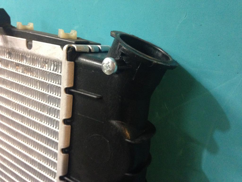

          We're doing the annual maintenance on the E30 right now. We have finally found an inexpensive radiator that is a perfect fit. You may recall that our original radiator was a composite that we had custom made.
          We have found that the Murray #433331 from O'Riley Auto parts is exactly the same as our original in shape, inlet & outlet, core size and header tank thickness. It also has a drain which will make coolant issues simple to deal with. One modification is necessary: cut off the little overflow nipple near the cap and plug it with an M6x10 screw. We tapped the hole in the nipple and used a little Permatex RTV sealant (for waterpumps, etc.). The radiator from O'Riley is only about $100.

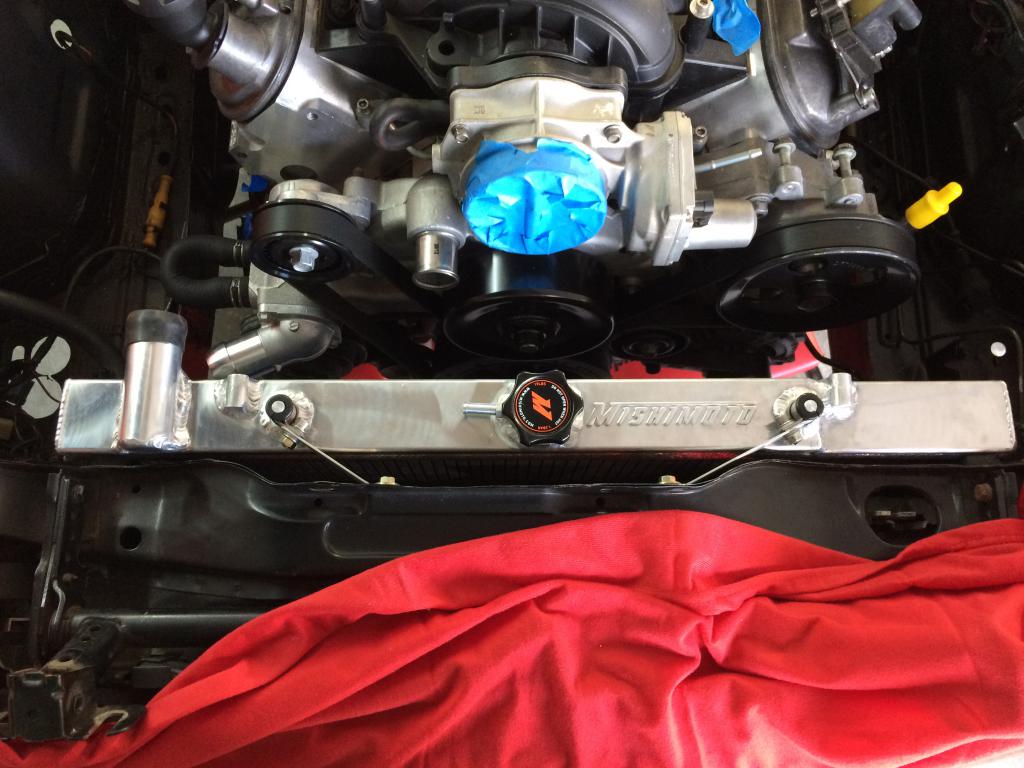

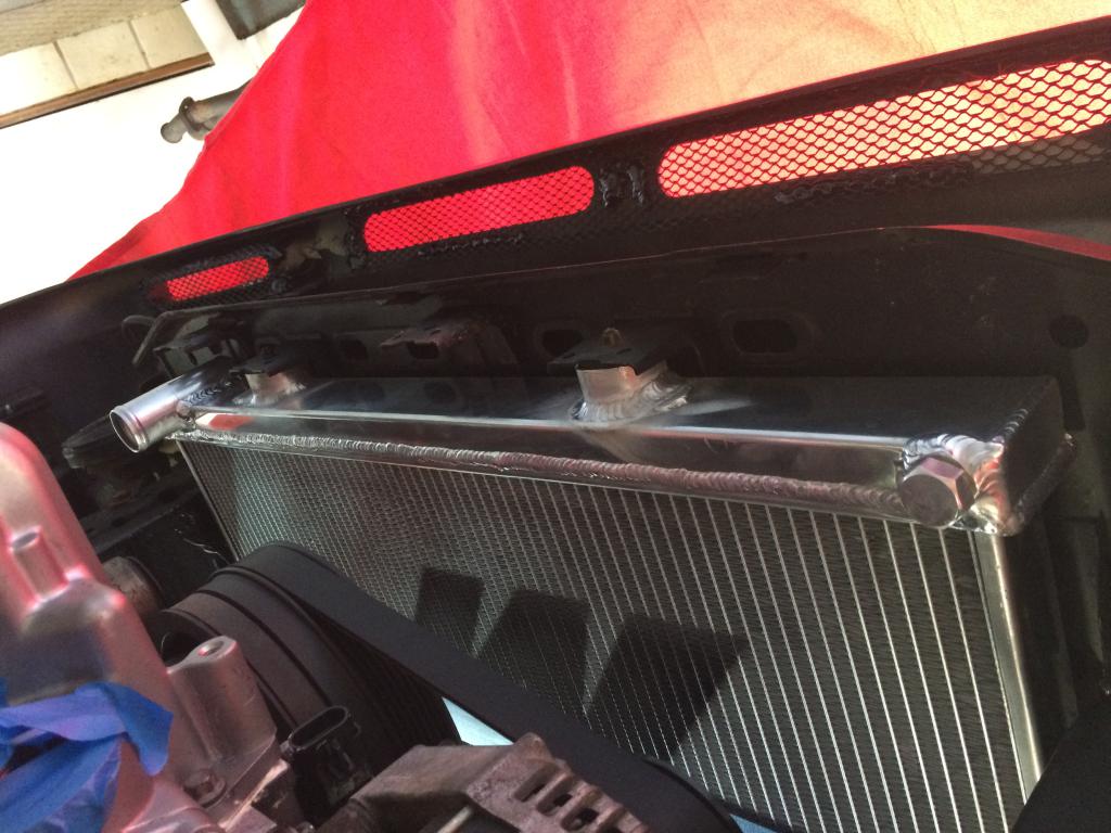

              I used this radiator
              The Mishimoto performance aluminum radiator for the Nissan Skyline is designed and engineered to maximize cooling efficiency by up to 30%, boost engine functions, and most importantly protect your car from overheating. Whether you drive your vehicle daily or take it for track runs. The Mishimoto aluminum Nissan Skyline radiator features a lightweight dual core, 100% brazed aluminum, and polished end tanks, enhancing the overall performance of your engine. Every Mishimoto aluminum radiator is a direct OEM fit, making installation effortless with no cutting or modification required, the ideal upgrade to the stock Nissan Skyline radiator. All Mishimoto radiators come with a high pressure 1.3 bar Mishimoto radiator cap and, as with every Mishimoto aluminum radiator, this radiator includes the Mishimoto Lifetime Warranty. A perfect match to the Mishimoto lightweight aluminum Nissan Skyline fan shroud kit for the R32.
              With these hoses
              http://www.autozone.com/cooling-heat...8_25589_10495/
              http://www.autozone.com/cooling-heat...22073_0_10495/
              For steam vent, I drilled and tapped into the top of the water pump and ran a 6" line from the steam tube to a thread barb inserted into the water pump
              You can see it in this picture
              Mounts were pretty straight forward, I cut the old mounts off the radiator support and then re-welded them where they were needed. I used the stock BMW radiator bushings to cushion the new radiator (had to drill the bottom just a bit). Top mounts were made using flat stock Al currently held in place with self tappers until my nut riveter arrives.

                  • garretvs
                    • 464
                    Our steam vent is tied into the upper radiator hose. The little radiator nipple interferes with our intake duct .... we did not want to make a new duct. Also, the E30 de-gas bottle
                    has its own over flow vent.

                        SGTSKID, thanks for the picture and information. That's super helpful. Those hoses look great. I am picking up m up tomorrow. I got the radiator yesterday and am mounting it tomorrow.
                        • trucupey
                          • Feb 2007
                          • 95
                          Here are the bottom mounts.
                          • trucupey
                            • Feb 2007
                            • 95
                            Radiator
                            Here is the top
