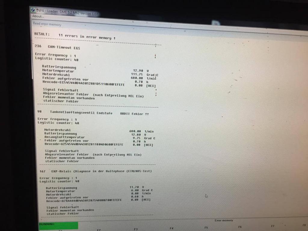

    Hi everyone
    I swap M62 to my e36

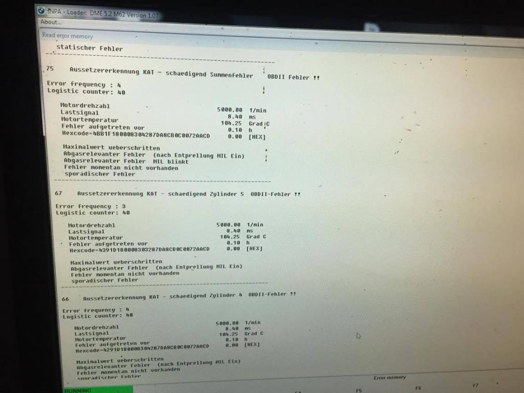

    Now i have problem with power, to the 4-5000 rpm have low power like you run with handbrake, around 5000 rpm kicked you and gooo , when i turn off and turn on ignition car runnings few minutes good , if i delete all errors and adaptation car runnings good , but after few km still flat power at low rpm.....
    inpa says anything about the knock sensors but errors is on the left and rights sides cylinders , its a low chance that both sensor will be bad ....
    there is only 2 o2 sensor , one is original old , one new denso
    exhaust is flat 70mm pipe , x-pipe, and bastuck end mufler from 330ci
    new spark plugs , every seal is new ,
    maybe is problem with fuel pump ? i dont now ....
    can timeout egs, and fuel pump releys
    They have nothing to do with engine power ....
