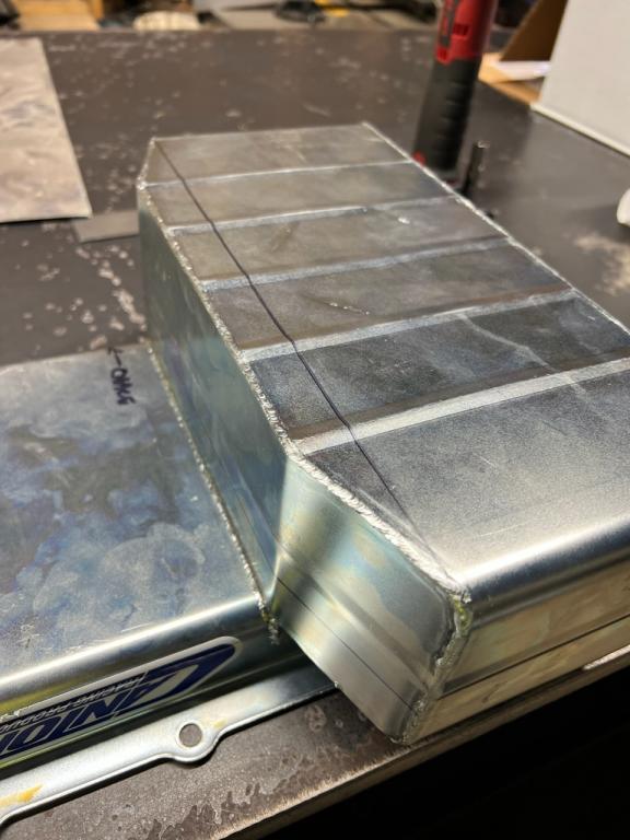

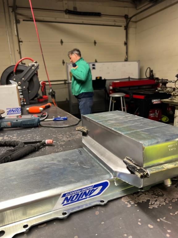

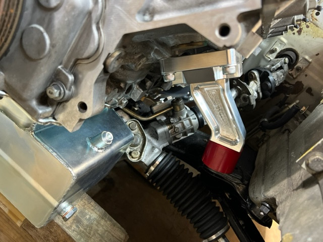

              Thread revival. I'm in the midst of an LS1 swap into my 85 318i chassis. I'm using the Sikky CNC mounts (which are amazing) and the Canton 15-276 front sump pan. With the Sikky mounts, the pan is contacting the steering rack. Curious if anyone else has had this issue? I'm considering a modest cut and re-weld of the front sump drop down on the Canton pan to gain some additional clearance. I'd rather clearance the pan than shift the motor forward. Opinions?

                I had the same problem on my '84. I moved the engine forward, IIRC because the t56 shifter was centered better that way. But I have a pretty horrendous memory.

                  Yeah, I elected to just cut the pan. This seems to have done the trick quite nicely. Lost about 1/2qt of oil capacity, but I should make that back up with oil cooler and such.
